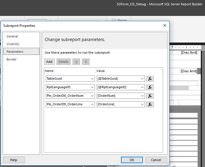

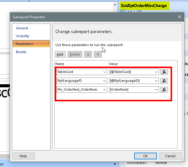

After a lot of digging, it appears that the subreport SOForm_OLMscCharges
is to blame.
When I remove that subreport, a 184 line Order takes a few seconds to render. With that subreport in, it times out. And this Order has no Misc Charges!

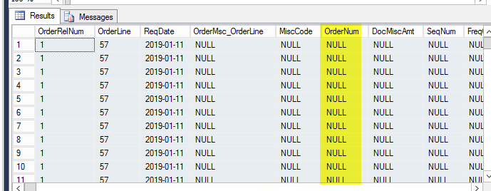

Running the subreport’s query query expression in SSMS, yields that it returns 31,000 rows. Again, this report has no Misc Charges (neither line nor header).
Copying the results from SSMS to Excel, shows that there are multiple records for each Order Line - I would have thought there would be one per MscCharge (so in my case zero records). I get 176 records per Order Line (8 shy of the 184 lines in the order).
I now see that the OrderNum field is coming up 'Null`
