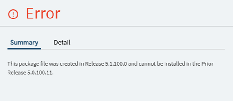

I’m trying to take some work we did in PILOT and load it into our LIVE system by creating a Solution via Solution Workbench.
However, the process errors out:
Totally makes sense as PILOT is updated a couple of weeks before LIVE. But this is preventing me to immediately move stuff between environments when versions are not the same.
Is there a best practice to managing this? Is there a way to prevent this?

For BAQs you can edit the version number in the export. You may be able to do the same for Solutions but I haven’t tried it yet.
The simplest way to avoid cloud is… Go On Prem :)… Then you are in total control of all of your environments… But then you forgo all the benefits of cloud… I’m sure there are a host of people queuing up to spruke the benefits as they read this…
Export everything from pilot before the update, or else wait until after live gets updated.
A lot of things can be moved piece meal between versions but its a lot of work to do it that way.
In the Make the software friendly for DevOps practices, source code would be saved by version but uploaded by capability. What I mean is that the source code is saved in the version in which it is created, but if compatible, could be imported into any version. It’s the import/export/solution system that’s blocking.
In the old days of web programming, we added all kinds of conditional code to handle various browser versions. They eventually gave that up and just tested for the capability and used what it could. I’d like to see that with customizations as well.
