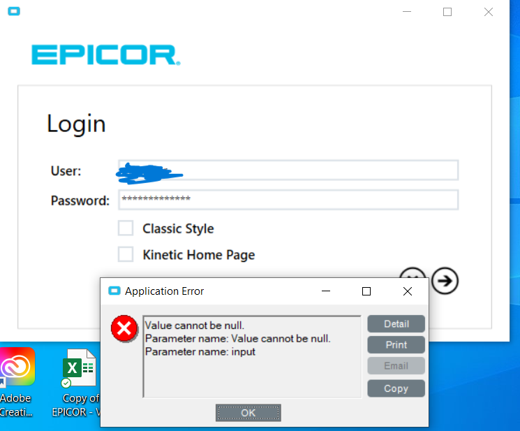

Starting two days ago, a number of users would get an error when trying to launch their 10.2.700 client. Sometimes they would try multiple times and it would launch or restart and it would launch. The header of error says Application error and then Value Cannot be Null. It doesn’t happen every time. I turned on Windows firewall logging on the client, app server, and sql server. I have found nothing related to blocks between client and app server or app server and db server.

It is not consistent, but appears to be more machine related. For example a user this morning double clicked the icon on her desktop and got the null error. Then she right clicked and it worked.
Would you mind clicking in the box and copying the text?
We can’t see all of it.

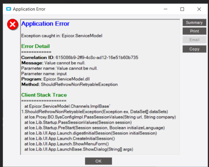

Application Error Exception caught in: Epicor.ServiceModel Error Detail
Correlation ID: 6d3537d9-a5d3-4295-a750-f4c4a40a4ed8
Message: Value cannot be null.
Parameter name: Value cannot be null.
Parameter name: input
Program: Epicor.ServiceModel.dll
Method: ShouldRethrowNonRetryableException Client Stack Trace
at Epicor.ServiceModel.Channels.ImplBase`1.ShouldRethrowNonRetryableException(Exception ex, DataSet[] dataSets)
at Ice.Proxy.BO.SysConfigImpl.PassSessionValues(String url, String company)
at Ice.Lib.Startup.PassSessionValues(Session session)
at Ice.Lib.Startup.PreStart(Session session, Boolean initializeLanguage)
at IceShell.SessionManager.InitializeInitialSession(Session initialSession)
at IceShell.SessionManager.<.ctor>b__32_1(Object _, SessionChangedEventArgs e)
at Ice.Lib.UI.SessionCache.OnInitialSessionChangedEvent(SessionChangedEventArgs e)
at Ice.Lib.UI.SessionCache.SetInitialSession(Session session)
at Ice.Lib.UI.SessionCache.set_CurrentSession(Session value)
at IceShell.SplashScreenApp.logon_LogonEnded(Object sender, EventArgs e)
at IceShell.Apps.LogonDialog.OnLogonEnded(Object sender, EventArgs e)
at IceShell.Apps.LogonDialog.StopLogon()
at IceShell.Apps.LogonDialog.DoWorkLogon()
at IceShell.Apps.LogonDialog.btnOK_ButtonClick(Object sender, InputEventArgs e)
at IceShell.ImageButton.Click(InputEventArgs e)
at IceShell.ImageButton.ImageButton_ClickOrTap(Object sender, InputEventArgs e)
at System.Windows.Input.MouseButtonEventArgs.InvokeEventHandler(Delegate genericHandler, Object genericTarget)
at System.Windows.RoutedEventArgs.InvokeHandler(Delegate handler, Object target)
at System.Windows.RoutedEventHandlerInfo.InvokeHandler(Object target, RoutedEventArgs routedEventArgs)
at System.Windows.EventRoute.InvokeHandlersImpl(Object source, RoutedEventArgs args, Boolean reRaised)
at System.Windows.UIElement.ReRaiseEventAs(DependencyObject sender, RoutedEventArgs args, RoutedEvent newEvent)
at System.Windows.UIElement.OnMouseUpThunk(Object sender, MouseButtonEventArgs e)
at System.Windows.UIElement.RaiseEventImpl(DependencyObject sender, RoutedEventArgs args)
at System.Windows.UIElement.RaiseTrustedEvent(RoutedEventArgs args)
at System.Windows.UIElement.RaiseEvent(RoutedEventArgs args, Boolean trusted)
at System.Windows.Input.InputManager.ProcessStagingArea()
at System.Windows.Input.InputManager.ProcessInput(InputEventArgs input)
at System.Windows.Input.InputProviderSite.ReportInput(InputReport inputReport)
at System.Windows.Interop.HwndMouseInputProvider.ReportInput(IntPtr hwnd, InputMode mode, Int32 timestamp, RawMouseActions actions, Int32 x, Int32 y, Int32 wheel)
at System.Windows.Interop.HwndMouseInputProvider.FilterMessage(IntPtr hwnd, WindowMessage msg, IntPtr wParam, IntPtr lParam, Boolean& handled)
at System.Windows.Interop.HwndSource.InputFilterMessage(IntPtr hwnd, Int32 msg, IntPtr wParam, IntPtr lParam, Boolean& handled)
at MS.Win32.HwndWrapper.WndProc(IntPtr hwnd, Int32 msg, IntPtr wParam, IntPtr lParam, Boolean& handled)
at MS.Win32.HwndSubclass.DispatcherCallbackOperation(Object o)
at System.Windows.Threading.ExceptionWrapper.InternalRealCall(Delegate callback, Object args, Int32 numArgs)
at System.Windows.Threading.ExceptionWrapper.TryCatchWhen(Object source, Delegate callback, Object args, Int32 numArgs, Delegate catchHandler)
at System.Windows.Threading.Dispatcher.LegacyInvokeImpl(DispatcherPriority priority, TimeSpan timeout, Delegate method, Object args, Int32 numArgs)
at MS.Win32.HwndSubclass.SubclassWndProc(IntPtr hwnd, Int32 msg, IntPtr wParam, IntPtr lParam)
at System.Windows.Forms.UnsafeNativeMethods.DispatchMessageW(MSG& msg)
at System.Windows.Forms.Application.ComponentManager.System.Windows.Forms.UnsafeNativeMethods.IMsoComponentManager.FPushMessageLoop(IntPtr dwComponentID, Int32 reason, Int32 pvLoopData)
at System.Windows.Forms.Application.ThreadContext.RunMessageLoopInner(Int32 reason, ApplicationContext context)
at System.Windows.Forms.Application.ThreadContext.RunMessageLoop(Int32 reason, ApplicationContext context)
at Ice.Lib.UI.ApplicationWatcher.StartApplication(ApplicationContext context)
at Ice.Lib.UI.App.IceShellLaunch.<>c__DisplayClass7_0.b__1()
at Ice.Lib.UI.App.IceShellLaunch.ShowMenuForm()
at Ice.Lib.UI.App.LaunchBase.ShowDialog(String[] args)
For some reason, your client is not getting the command line arguments passed to it.
I’d recreate the shortcut, and/or look into the mouse and client machine.

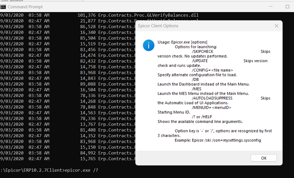

Anyone know what the /skip flag means? Many users getting the Null error have this /skip
C:\Epicor\ERP10.2.7Client\Epicor.exe /skip “/Config=XXX_EPICOR_700.sysconfig”
I have also seen some stuff caused by personalizations so you might want to do a personalization purge for that user*
/skip says, “Don’t look for client updates”
thanks. with /skip we were gettiing null error message.
Changed it to /skipcheck and no more null message.
