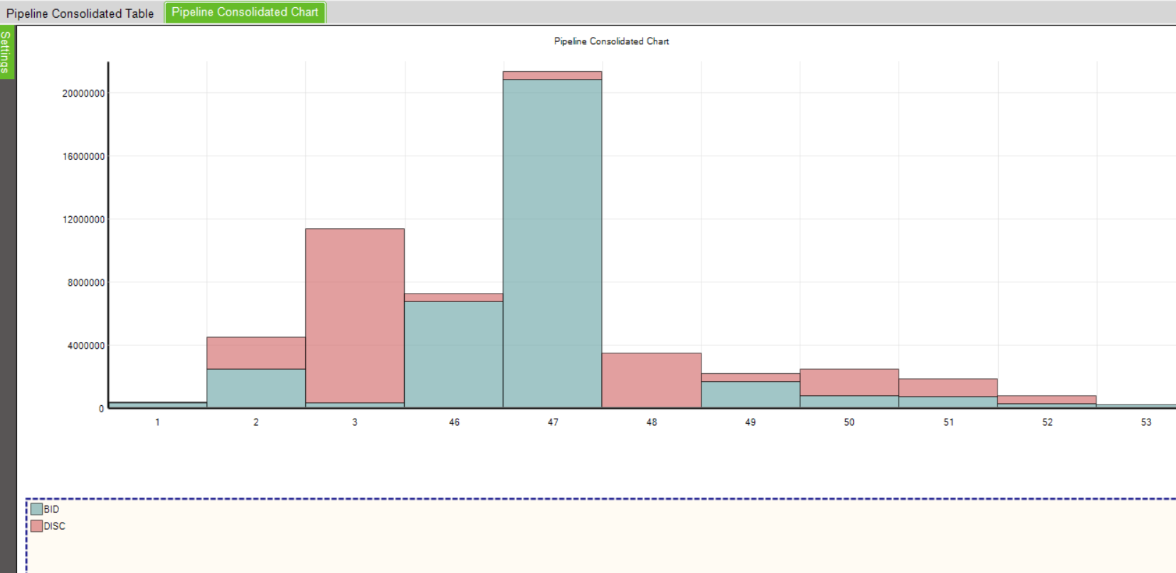

I need to display our quotes by stage (Bids & Discussion) over a 12 week period in dollars and count. The chart function in the dashboard module seems very limited in what it an do and I cannot add detail to the chart or modify. I’d really like to add a drill down to the chart but that seems impossible.
I have attached a screen shot of the chart. I added some calculated fields to get me the current week and the week of the quote entry. I then have the query run a check to see if it the quote is within our 12 week period so only those display.

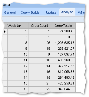

I have three calc fields
int WeekNum = datediff(week,OrderHed.OrderDate, Constants.Today);  // GroupedBy
int OrderCount = count(OrderHed.OrderNum);
decimal OrderTotals = sum(OrderHed.OrderAmt);
Yields:
(that’s from my Test DB, which hasn’t been updated since about 8 weeks ago)

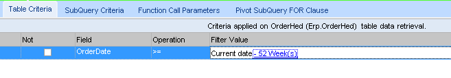

Here’s the table Criteria to get the last 12 weeks
You may have to get creative if you want weeks to start on a specific day of the week. Like if week 1 is this Monday through today, week 2 was last monday through the most recent sunday, etc…
