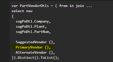

PartVendorDtls is a LINQ query that pulls in Company Part Plant data and some additional information building
var PartVendorDtls = ( from in join ...
select new
  sugPoDtl.Company,
  sugPoDtl.Plant,
  sugPoDtl.PartNum,
  SuggestedVendor {},
  PrimaryVendor {},
  AlternateVendor {},
}).Distinct().ToList();
/* This seems to work as intended */

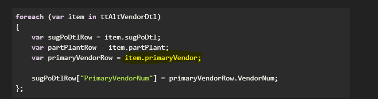

/* I can force a join here by explicitly declaring type*/
foreach (var item in ttAltVendorDtl)
    var sugPoDtlRow = item.sugPoDtl;
    var partPlantRow = item.partPlant;
    var primaryVendorRow = item.primaryVendor;
    sugPoDtlRow["PrimaryVendorNum"] = primaryVendorRow.VendorNum;

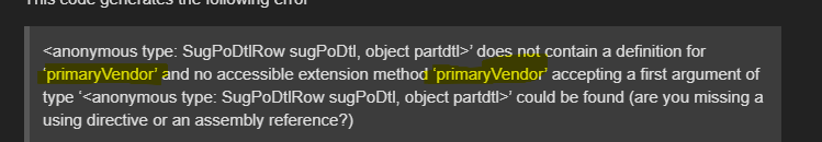

This code generates the following error
<anonymous type: SugPoDtlRow sugPoDtl, object partdtl>’ does not contain a definition for ‘primaryVendor’ and no accessible extension method ‘primaryVendor’ accepting a first argument of type ‘<anonymous type: SugPoDtlRow sugPoDtl, object partdtl>’ could be found (are you missing a using directive or an assembly reference?)
I am trying to avoid creating a public class, but I will if I have to make this work.

When you set your sugPoDtlRow, your ttAltVendorDtl item already contains that row as a variable. But your item doesn’t contain a partPlant, just the partdtl which is a row from the poSummaryData. I think you would need to access the items in that row, although I’m not positive of the syntax. Something like:
    var partPlantRow = item.partdtl.partPlant;
    var primaryVendorRow = item.partdtl.primaryVendor;
I could be wrong but

I get the error:
‘object’ does not contain a definition for ‘Company’ and no accessible extension method ‘Company’ accepting a first argument of type ‘object’ could be found (are you missing a using directive or an assembly reference?)
This makes me think that poSummaryData is not getting properties assigned, preventing using them in subsequent queries or code.
