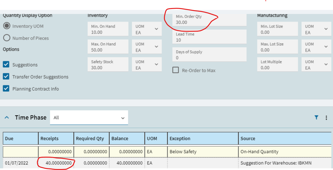

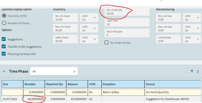

When I tested, Min Order Qty was not utilized, as you can see below.

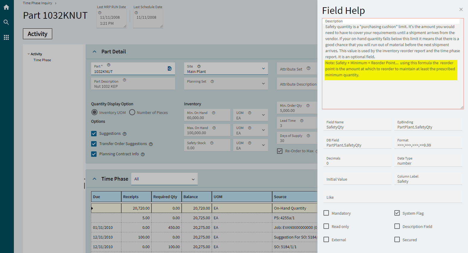

Hi Pilio.lee

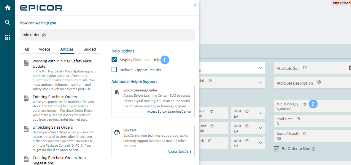

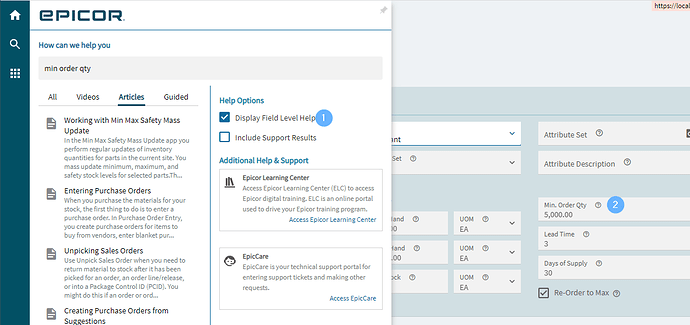

This is covered in field help and the documentation
Enable here
Hi Pilio,

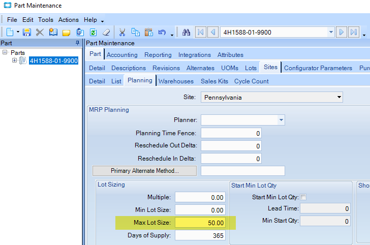

MOQ is the minimum to be ordered. The system will not use that as maximum to be ordered unless you complete an additional parameter such as Max lot size, etc… Also, I have seen some parameters ignored when below SS. This might require associated “urgent” parameters to get completed as well.
Nancy
thank you for your advice!

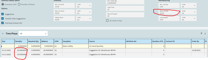

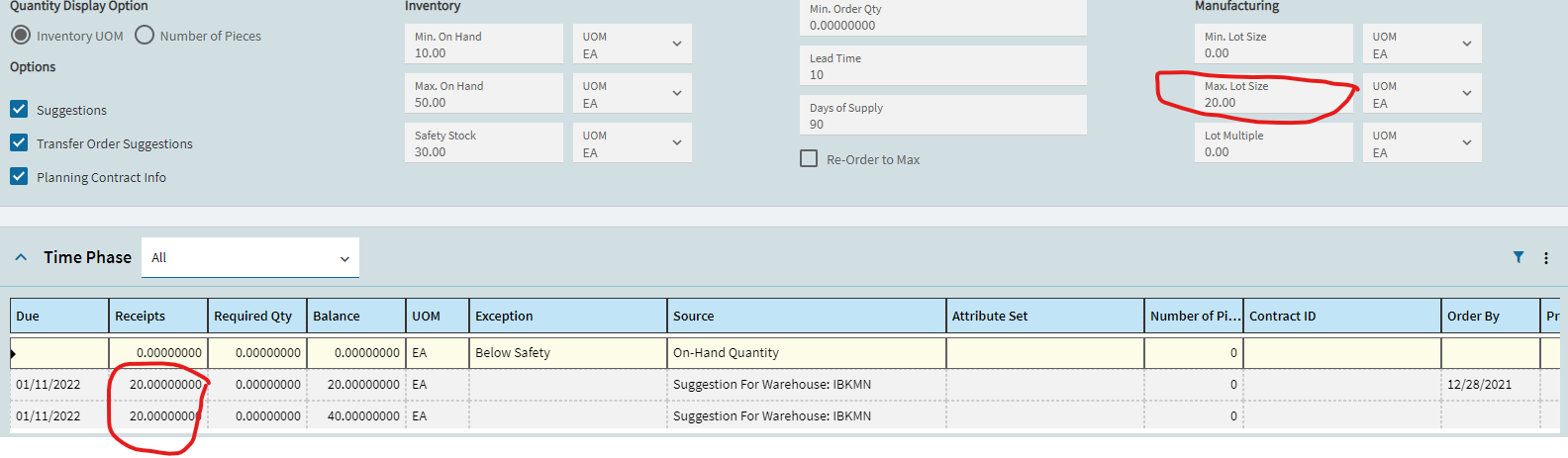

As suggested by your suggestion, I tested with Max Lot Size and this problem was solved. I found that the function I wanted was to use Max Lot Size and not Min Order Qty.

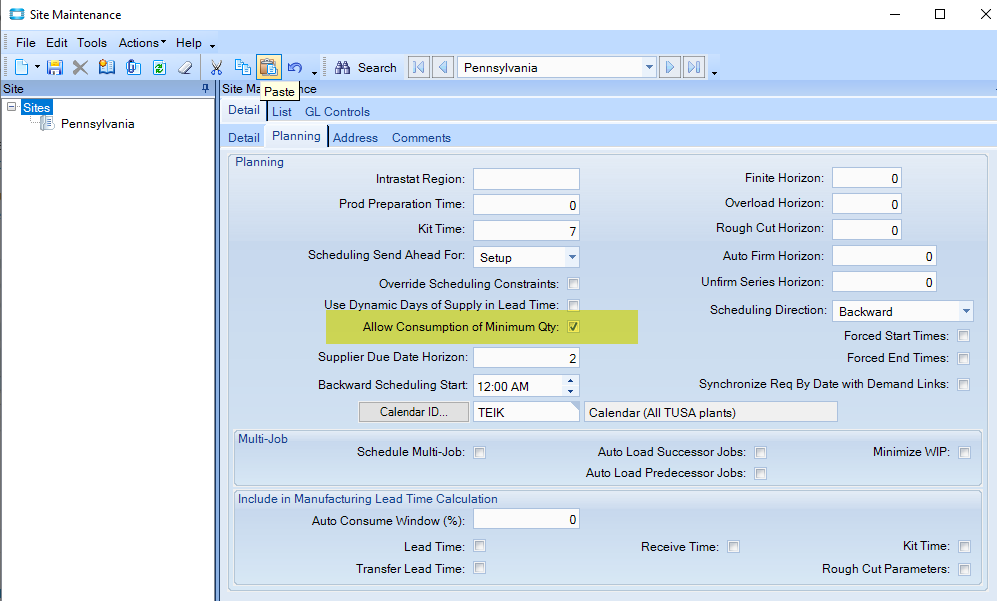

My understanding of this is that Due date is immediate because you are below SS. I think that the SS number is supposed to be to cover intermittent / unusual demand. When below it, this quantity considered “set aside”, the system wants to get it again right away. Minimum on hand can be used for average usage. To have system not require MOH right away, similar to SS, you need to check Allow consumption of minimum Qty, per below site maint screenshot. So Reorder level = SS + MOH
HTH,
Nancy
Thanks for the good advice!
As you explained, it worked out. you’re my good adviser.
