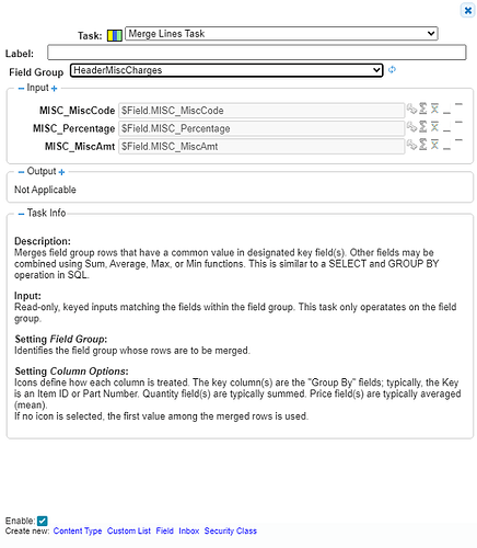

I stumbled across this task, which I’ve never used, but it could potentially add some of the functionality we’re after. It’s possible that the key field would be automatically sorted on, but without testing i am unsure.

The new Merge Task Lines task does not sort the contents of the field group.

The Merge Lines Task seems to have its place, but it is definitely not for sorting.

No, sorry for the confusion. I was simply trying to see if the Merge Lines Task would sort by default on the key field. It doesn’t.
The Merge Lines Task does merge lines together where you designate the key field and those values match, though. From my perspective there isn’t a great number of applications for this task, but I would like to know if others have found it to be useful. The one application I do see it being helpful with is in aggregating line miscellaneous charges before applying those to the GL Analysis in ECM.
