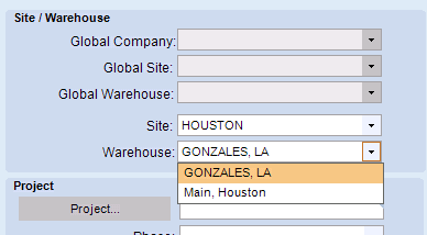

If I have two warehouses for one site, I can’t specify the secondary warehouse as the ship to.
I can select it as the destination so that QOHs are maintained, on the PO Release:
But the PO prints with the Sites Address (which is the same as the warehouse “Main, Houston”).
The PO allows choosing the Company, or Site, as the ship to, but not the warehouse
