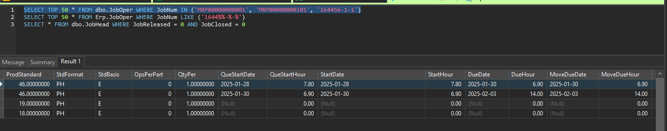

Looking for some quick input on something ProdCal related. We are having an issue since upgrading to 2024.2 where on occasion a job will generate in MRP without any dates and when you go to try and finite schedule it it throws the exception below
System.InvalidOperationException: Nullable object must have a value.
   at System.Nullable`1.get_Value()
   at Erp.Internal.ES.SchedEngine.mvOpSchedJobBwd(Nullable`1 PassedDueDate, Decimal`1 PassedDueHour) in C:\_releases\ERP\ERP11.3.200.5\Source\Server\Internal\ES\SchedEngine\SchedEngine.cs:line 17504
   at Erp.Internal.ES.SchedEngine.processJob(Boolean isFirstProcess) in C:\_releases\ERP\ERP11.3.200.5\Source\Server\Internal\ES\SchedEngine\SchedEngine.cs:line 22350
   at Erp.Internal.ES.SchedEngine.MoveJobItem(String ttScheduleEngineCompany, String ttScheduleEngineJobNum, Int32 ttScheduleEngineAssemblySeq, Int32 ttScheduleEngineOprSeq, Int32 ttScheduleEngineOpDtlSeq, Nullable`1 ttScheduleEngineStartDate, Int32 ttScheduleEngineStartTime, Nullable`1 ttScheduleEngineEndDate, Int32 ttScheduleEngineEndTime, Boolean ttScheduleEngineWhatIf, Boolean ttScheduleEngineFinite, String ttScheduleEngineSchedTypeCode, Boolean ttScheduleEngineOverrideMtlCon, Int32 OverRideHistDateSetting, Boolean ttScheduleEngineScheduleDir, Boolean il_surpressexceptions, Int32 ttScheduleEngineAllocNum, String& WarnLogTxt, Boolean ttScheduleEngineMinimizeWIP, Nullable`1 ipOverrideBounceDate, Boolean useLotExpiration) in C:\_releases\ERP\ERP11.3.200.5\Source\Server\Internal\ES\SchedEngine\SchedEngine.cs:line 14043
   at Erp.Internal.ES.SchedEngine.MoveMRPJob(String ttScheduleEngineCompany, String ttScheduleEngineJobNum, Int32 ttScheduleEngineAssemblySeq, Int32 ttScheduleEngineOprSeq, Int32 ttScheduleEngineOpDtlSeq, Nullable`1 ttScheduleEngineStartDate, Int32 ttScheduleEngineStartTime, Nullable`1 ttScheduleEngineEndDate, Int32 ttScheduleEngineEndTime, Boolean ttScheduleEngineWhatIf, Boolean ttScheduleEngineFinite, String ttScheduleEngineSchedTypeCode, Boolean ttScheduleEngineOverrideMtlCon, Int32 OverRideHistDateSetting, Boolean ttScheduleEngineScheduleDir, Boolean il_surpressexceptions, Int64 instancetasknum, Int32 ttScheduleEngineAllocNum, Nullable`1 GlobalBounceDate, Boolean ttLogfile, String& WarnLogTxt, Boolean useLotExpiration) in C:\_releases\ERP\ERP11.3.200.5\Source\Server\Internal\ES\SchedEngine\SchedEngine.cs:line 14513 --- MoveMRPJob
Here are two MRP generated records that are both unfirm and what difference we are seeing that causes the issue.

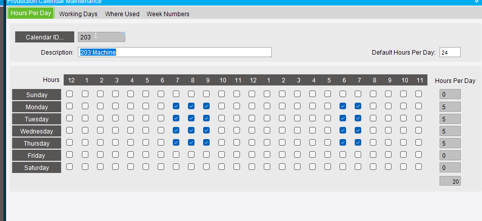

Anyways support is telling me that our issue is split prod calendars, but
  • First of all, if you have a resource available from say 6pm to 6am you have to split but it’s not really split? or…?
  • Second, we have been running this way since 9.05.602A without issue, so… ā€œwe’ve been lucky for 12 yearsā€ I don’t know about that
  • Third, when I add 4pm and 5pm to the calendar below the dates generate in MRP correctly, but it’s still a split calendar. (If I add 8, 9, 10, 11 dates don’t generate either. It’s all sorts of whack)
I’m just looking for validation that there shouldn’t be any issue with running a calendar split like this. The reality from a scheduling perspective is Epicor doesn’t support scheduling employees (cross shift issues) so really all we can do is constrain our machine’s calendars to when we have employees roughly available to run them. Essentially due to employee constraint yes a 5 hour job could be scheduled for 12 and that would be unfortunately accurate. I wouldn’t want it to schedule it for 5 hours from a Gantt chart perspective.

Not the answer you want, but I was always told (from back @ 9.05) that you never split the calendar like this, as it will ā€˜confuse’ the scheduler.

My last company saw the same weirdness with a split calendar and the consultant told us NOT to split the calendar. We removed the blank checkboxes in the middle and our issues were resolved. This was on version 2023.2 or 2024.1

Updated all calendars to non split calendars and the issue still exists. I went as far as deleting all jobs on the same resources until I found the 1 that was causing the issue. No idea why it’s causing an issue yet, but I can reproduce over and over if I delete this other job from the schedule I can schedule the job throwing the null error, as soon as I put that other job back on the schedule MRP derps out on my broken job. There is data corruption somewhere happening but no idea where. The other thing that can fix it is if I push the req due date of the job out like 6-7 weeks then it will schedule just fine too. It’s like it’s hitting a scheduling constraint and not gracefully handling it.
Also I contend in some cases it would be impossible to not have a split calendar. For example say you have a resource that is available only from 7pm to 7am. You will have a ā€œsplit calendarā€ as far as a given day is concerned. This should not be an issue, if that’s the case then epicor shouldn’t give us checkboxes, just a number box asking how many hours a day a resource is available and call it good. At that point much like the points in who’s line the time won’t matter. Not much of a schedule if your start and end times are arbitrary.

I was told that as long as the available hours did not have a split, you could do the 7am to 7pm checkboxes without an issue. It’s what I was told, and I questioned it because I thought it should be like you said. In fact, I was trying to make the machine unavailable for the lunch ā€œhourā€ and was told not to do that, but rather make the machine available for 1 hour less per day and it would ā€˜work itself out’.
