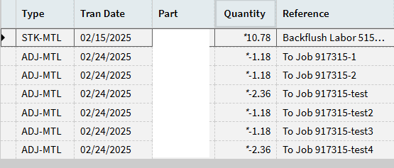

For some reason that I can’t put my finger on, my child job is coming out with exactly double the quantities requested for split, everywhere except the make to stock demand link, which is coming out as expected.
917315 is source job, ive done all the job splits in the screenshot with the same child job qty, 917315-test and 917315-test4 programmatically, the rest via job entry → split job.
Following the trace, I can’t seem to find any difference in my input vs. Split Job - anyone have any insight?

The screenshot may be slightly misleading,
Each visible row there is an independent job split (separate run-through of split job)
*-1.18 is the correct amount that should be split off given my input,
*-2.36 is the doubled amount.
The screenshot shows 6 independent runs of job split, all at the same child qty. 4 were done with the Job Split module, and 2 with the function.
