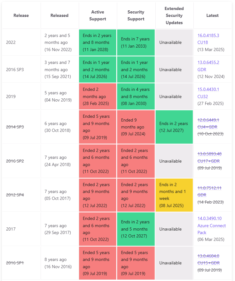

Separate from the Kinetic requirements, here’s Microsoft’s support for SQL Server:

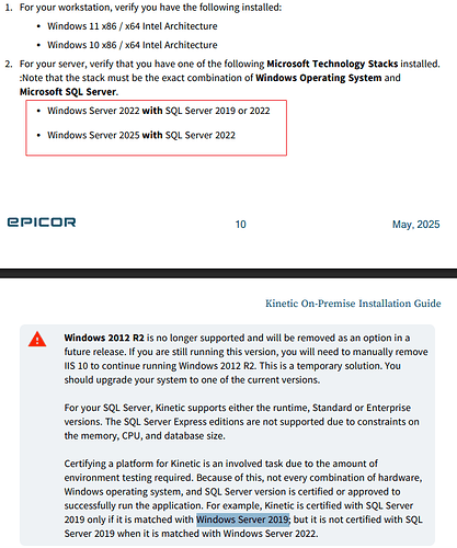

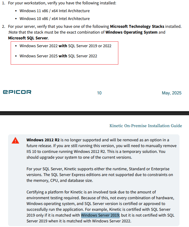

It seems that “stacks” Window Server 2016 with SQL Server 2017 or Windows Server 2019 with SQL Server 2017 or 2019 are not longer supported for 2025.1 according to Kinetic Install Guide 2025.1.pdf :smiling_face_with_tear:
and for 2025.2 will probably be only these two
