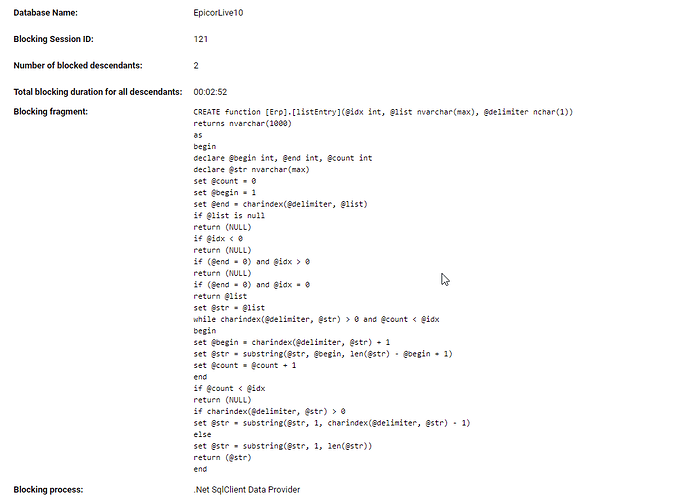

SQL Blocking Process ( CREATE function [Erp].[listEntry] )
We installed some SQL monitoring tools a few weeks ago and we’ve been learning all sorts of things about the Epicor DB.
Once thing we keep getting repeatedly is a Blocking Process usually triggered by a BAQ
What’s strange is that this function already exists but somehow Epicor BAQ process runs this create function and it causes some locking issues.
Any idea why this is and how to stop it ? @Rich

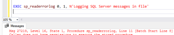

I get alot of these, following proper SQL Permissions by not giving the Service Account full DB Access to dbo.

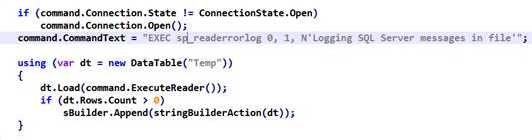

I narrowed it down, they are basically trying to capture the SQL Error Logs from the file and return it to the dll for whatever reason.
AppServerStartupEvent.cs

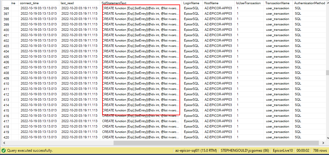

One again we are back here again 790 Record Locks in our DB right now
Nearly all of them are trying to “CREATE” the Erp.ListEntry function which doesn’t make a lick of sense since that function is always there.
We’ve been able to narrow down the issue to multiple people doing Invoice / Cash / AP Postings at once. But it is absurd, basically two or more people try to post a large Invoice / Cash group and I guess as part of that process somewhere SQL / or LINQ 2 SQL tries to re-create those functions which causes record locks.
It brings us down to our knees. I have to kill one of the transactions for the other one to process and even then sometimes it chains up to the next transaction in the batch.
