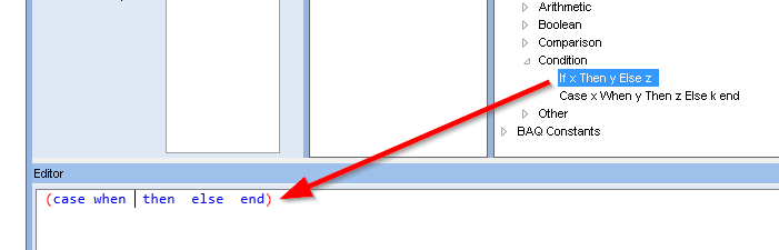

Since this expands into the SQL phrase, I’d put the whole thing in a set a parenthesis:
(case when Part.UD_UsePFI_c = 1 then
round((ShipDtl.OurInventoryShipQty + ShipDtl.OurJobShipQty) / CAST(OrderDtl.PFI_FEET_c AS decimal) + (OrderDtl.PFI_INCHES_c / 12.0) , 0)
else ShipDtl.OurInventoryShipQty + ShipDtl.OurJobShipQty end)
BAQ builder does that when you double click the If x Then y Else z
