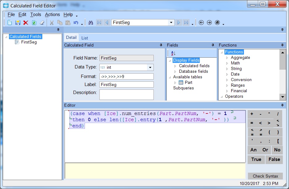

Oooh, oooh, I want to play. Here’s a complicated way to do it:
Basically, test if there’s a “-” by using the numentries command and if so, return the length of the first entry. All 3’s will have a dash in the 4th position. Not nearly as efficient as the other solutions though unless your next step is to return the first segment.
