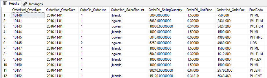

I’m not too experienced with SQL, but I wrote a query to display all of our orders for November in 2016.
I have these fields displayed/selected:
Here’s the query -
  • select
    [OrderHed].[OrderNum] as [OrderHed_OrderNum],
    [OrderHed].[OrderDate] as [OrderHed_OrderDate],
    [OrderDtl].[OrderLine] as [OrderDtl_OrderLine],
    [OrderHed].[SalesRepList] as [OrderHed_SalesRepList],
    [OrderDtl].[SellingQuantity] as [OrderDtl_SellingQuantity],
    [OrderDtl].[UnitPrice] as [OrderDtl_UnitPrice],
    [OrderHed].[OrderAmt] as [OrderHed_OrderAmt],ProdCode,
    CASE WHEN [OrderDtl].OrderLine <= 1 THEN [OrderHed].OrderAmt else 0.00 end as Calc_OrderAmt
  • from Erp.OrderHed as OrderHed
    inner join Erp.OrderDtl as OrderDtl on
    OrderHed.Company = OrderDtl.Company
    And
    OrderHed.OrderNum = OrderDtl.OrderNum
    where [OrderHed].[OrderDate] > ‘2016-10-31’ and [OrderHed].[OrderDate] < ‘2016-12-01’
So my goal for this query is to be able to calculate the total OrderAmt - but as you can see there’s duplicate rows for orders that have more than one line so the total is off by quite a bit…
I tried “CASE WHEN [OrderDtl].OrderLine <= 1 THEN [OrderHed].OrderAmt else 0.00 end as Calc_OrderAmt” but that didn’t work since we have a few orders that don’t start with line 1 and those OrderAmts come in as 0.00. Is there a statement where it only grabs the one OrderAmt per order? Or will I have to build a different query with Invc tables and do something like OrderDtl.SellingQuantity * OrderDtl.UnitPrice + InvcMsc.MiscAmt ?

Few ways to do this.
All depends on what you want your report to show. If it is just order and total, just use OrderHed, and don’t join the OrderDtl table. You will get one header row for each detail row with the order.
If you need OrderDtl information then you need to calculate each line from the OrderDtl by sellingQuantity * unitPrice. Then you can ignore the OrderHed.OrderAmt.
You also talk about invoice. Order and invoice dates might be in different months, just be careful with how you show the data there.
We can’t just do SellingQuantity * UnitPrice since there’s Misc charges on a lot of orders. (that’s what I meant by grab a few invoice tables… e.g., InvcHed, InvcMisc.)
We’re using SQL here instead of a BAQ because this query is for a SSRS report that a consultant is working on. We have PY Current Month, YTD, PYTD, etc. And the totals are all off because of the duplicate rows for line data. The problem is we want to see the line information, but we want the totals to be correct… One idea I had was to create a calculated field that basically said OrderAmt / TotalLines - then the total would be correct; but the TotalLines information is incorrect for some orders.
Now I need to figure out how to make a calculated field that counts the amount of lines per order. Then either DMT the correct results into the TotalLines field, or just use the calculated field
edit: Nevermind - I think the TotalLines field is actually showing correct results… Excel screwed me over
So I decided to go with a calculated field that says “[OrderHed].[OrderAmt] / [OrderHed].[TotalLines] as LineAmt”
We’re probably going to keep this field hidden and then only calculate the totals off of it. That way users can still see line detail, order amounts, and the correct totals but they won’t see this “fake” line amount…
