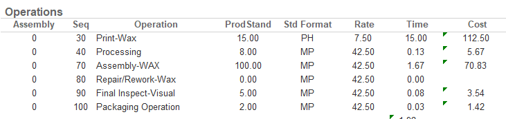

As an example here are all the operations for assembly 0…
So the Print(or machine) total shoud be 15… but because that value is being repeated for all the other operations it is ending up to be 75

Further clarification. There is one operation in the above report that is not being selected by design. That is why the total is 75(15 x 5) instead of 90(15 x 6) 6 being the total number of operations for that assembly.
