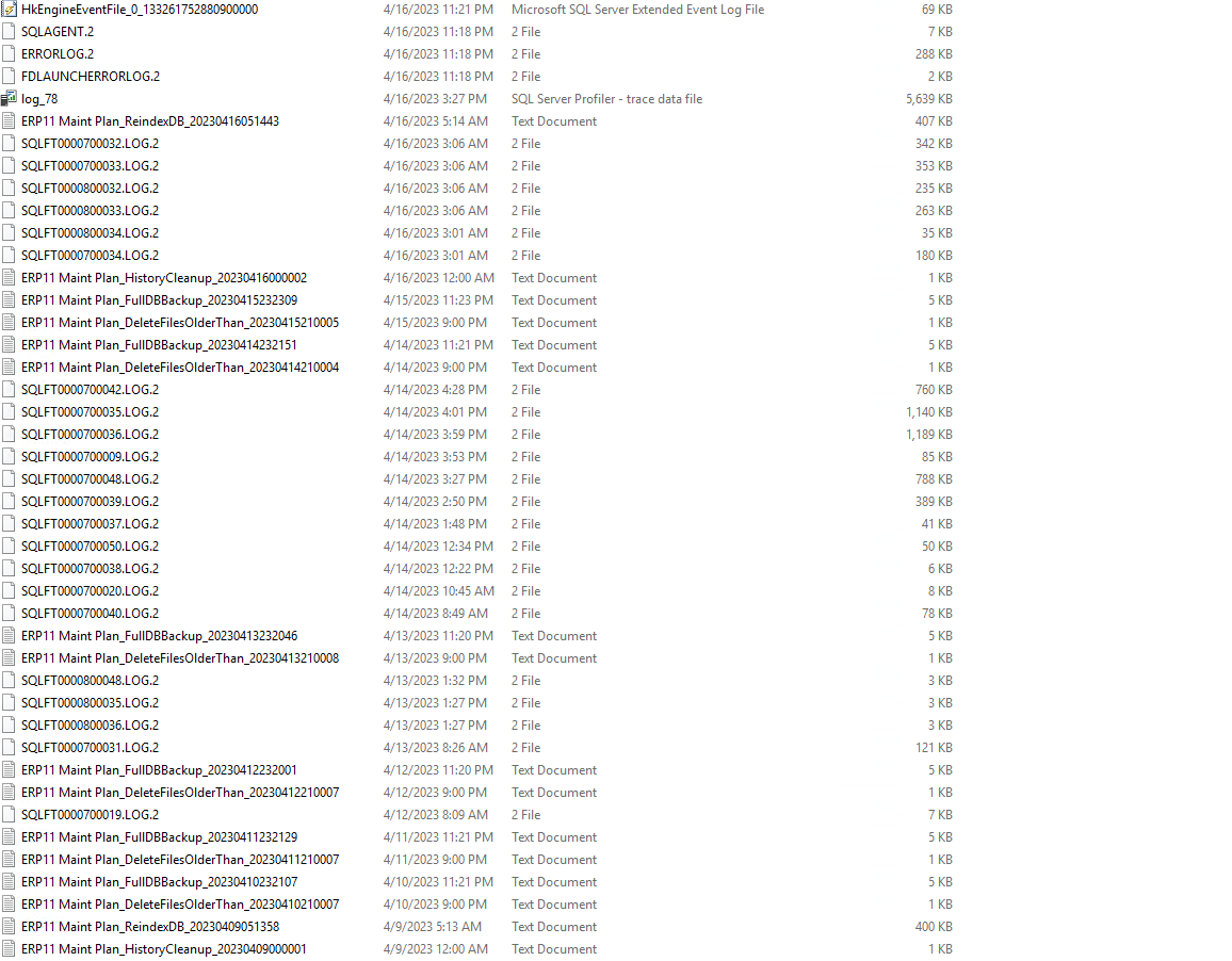

We are running low on space our SQL server. I found a lot of old log files that could free up some space. I was wondering if this would cause any trouble? File path look as follows on server.
C:\Program Files\Microsoft SQL Server\MSSQL15.KINETICSQL\MSSQL\Log
It is full of old maintenance log files, Trace Data files, and extended log files.
From what I see, the files look recent, so I would not just delete.
Do a Backup of the DB and Transaction Logs, which will clean them up and also enable Circular logging for just a bit to clear them out and then turn off Circular Logging to create them freshly again.
As Greg mentioned though, they don’t look like they are taking that much space from your screenshot, and if things are that tight, it might be best to also look at moving the LOG files to another disk which you can do so they are not on the same disk as your DB. The logs will grow automatically so they can run you out of space!
