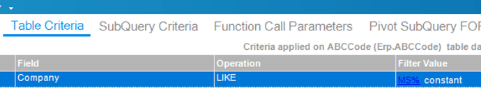

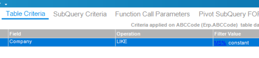

Switch to “specified constant”
If you need expression for some reason, wrap it in single quotes
Company LIKE ‘MS%’
@klincecum Trying to avoid Specified because I have a large list and don’t want a long list of Criteria.
Would rather be able to manage 1 expression.
Field: Company
Operator: Like
Expression: 'MS%' or ABCCode.Company LIKE '%4'
or
Field: Company
Operator: =
Expression: ABCCode.Company AND ABCCode.ABCCode = 'A' OR ABCCode.ABCCode LIKE 'B%'
Clear as mud ?
