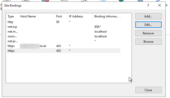

The fix is fairly straightforward. ON the Epicor server you should have been prompted to setup a self signed cert for computername.domain-name.local during setup or adding of the server to admin console. I cant remember exactly where it happens. Anyway. Pop open IIS Admin and go to the default site. Open the Bindings configuration. We are going to add a second HTTPS binding (first image) as you see below. One one of them you will add the epicor.public-domain.com certificate. (Second Image) and on the other one you will add the self signed .local certificate and select the Require SNI check box. (Third image)
RemoteDesktopManager64_2022-07-27_07-49-57
RemoteDesktopManager64_2022-07-27_07-49-33
RemoteDesktopManager64_2022-07-27_07-49-08
Once this is configured Admin console should connect just find using the computername.domain-name.local certificate and end points will work properly using the public epicor.public-domain.com certificate… Make sure you add your endpoint and cert to the deployment
Let me know if you have issues. This all worked for me.
