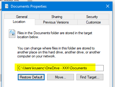

In File Manager (AKA - Windows Explorer), I set the location for my documents to be on my OneDrive, like:
And everything works fine. Until … Another program decides that it will use %USERPROFILE%\Documents

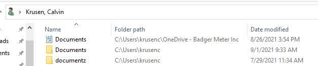

Using File Manger and browsing to my profile, I see I have a folder named “Documents” (generic folder icon), as well as one named “Documents” (identical name, but with a “library” type icon).
The yellow Documents folder (dated 9/1/2021) has just a single sub-folder (SSMS), with no files in it. I can delete the SSMS sub folder (leaving “Documents” empty), but cannot delete the Documents folder.
