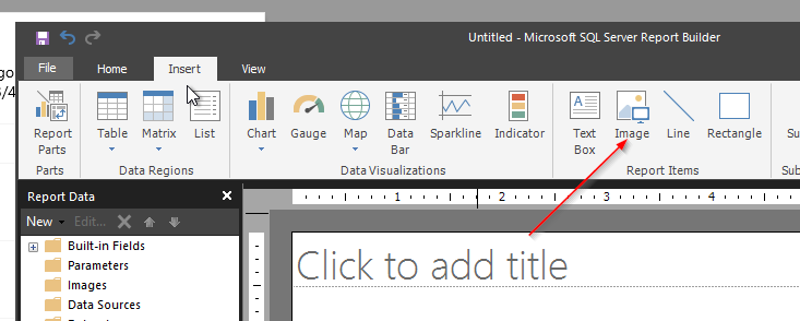

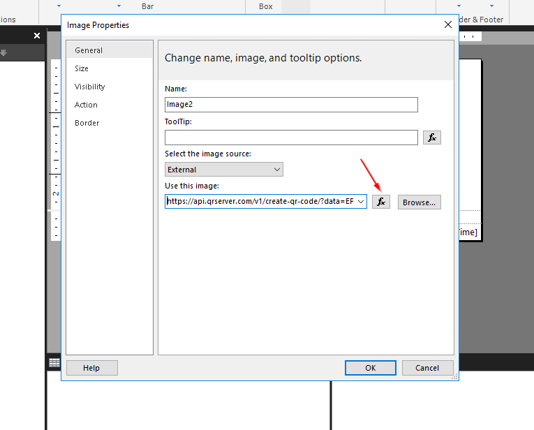

AH! Then maybe even easier. Just stick an image on the report and set the Source of the image to be that External URL (formed using an Expression combined with whatever field holds your value)
That is a lot easier. Crap, I hate it when I find out that I am making things more complicated then it needs to be.
