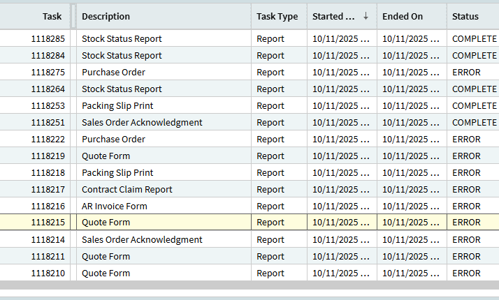

We are having the same issue with this. Only the standard SSRS reports are working, none of our customised ones.
Trish, are you saying that none of the custom reports are even running or that you can’t see the changes to any modifications you’ve made?
Not running. When we had no errors in Pilot.
