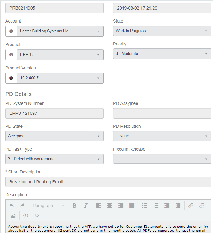

We have had the same issue and have a Problem Number through EpicCare (they have accepted that it’s a bug).
