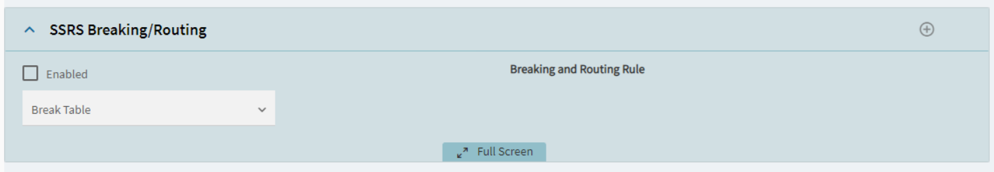

To explain it better, in Kinetic Cloud environment if you ty to create a new SSRS Breaking/Routing the Add button is just dim and you can’t click on it.

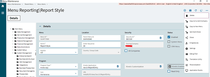

Reason for this is because in the Menu Maintenance, the Program Type has been set to Kinetic App already.

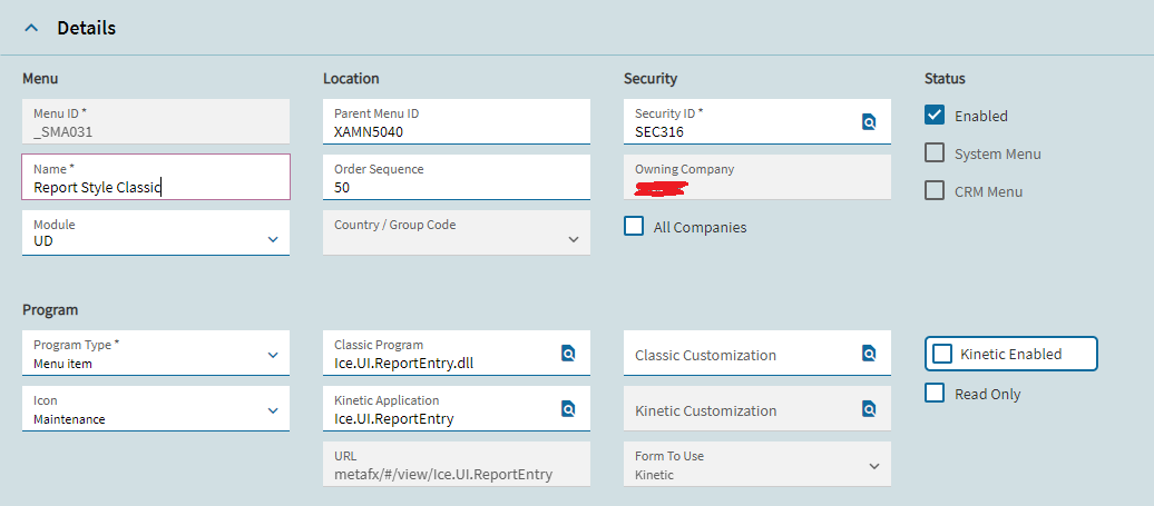

Solution? Create a new Menu and set the settings below or refer to the image below.
Program Type: Menu Item
Classic Program: Ice.UI.ReportEntry.dll
Kinetic Application: Ice.UI.ReportEntry
Note: you will only be able to open this in the Smart Client and not on the Web browser.

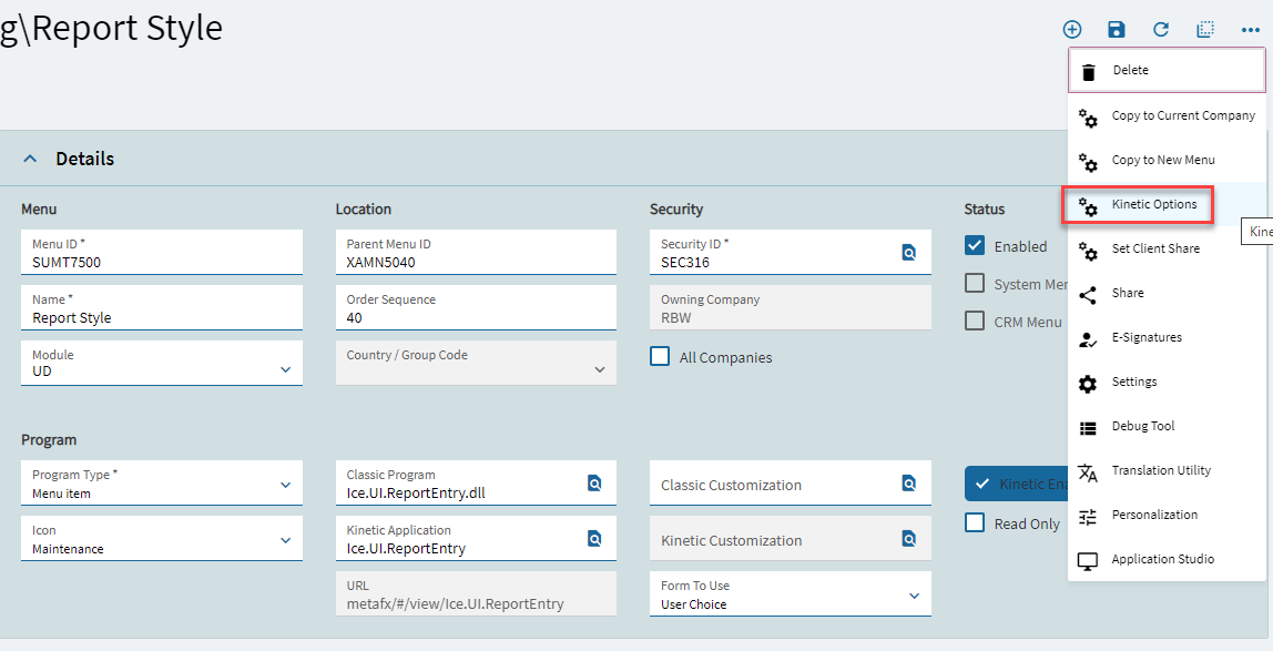

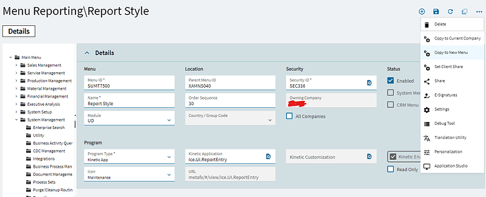

There is also an overflow menu option in the Kinetic menu maintenance called Kinetic Options (after you copy to current company in cloud) that will allow you to change from classic to kinetic without creating all new menu items. If you leave Enable User Override, you can also use the preferences to switch between classic and Kinetic. The change did appear on the menu maintenance screen until closing and reopening. I don’t believe the opening of the menu item will take effect until after you close and reopen Epicor.

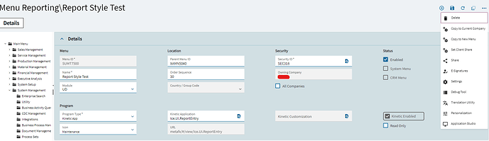

I am not seeing this option when I click copy to current company. Is there something I need to enable before this is visible?
Try saving, and go out and back in to Menu Maintenance.
I still don’t see it in the overflow

Try copy to current company first should open up that option. My screenshot above is from report style.
