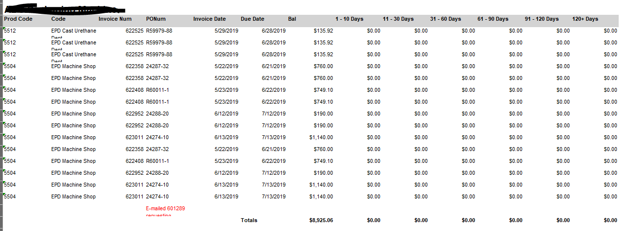

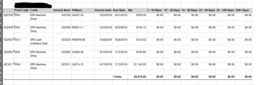

I have this SSRS report, exported to Excel:
Its shows aged invoices and the total balance for each customer. The only grouping i have setup is by customer in order to have a total for each customer.

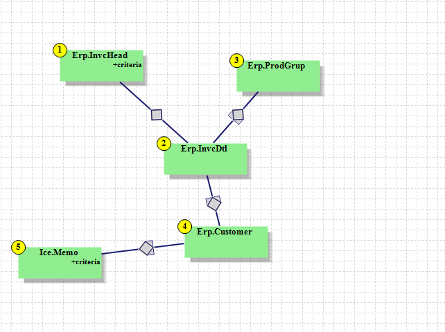

I have been asked to add all the memos for each customer onto this report. So in the BAQ i had to link the Memo table.

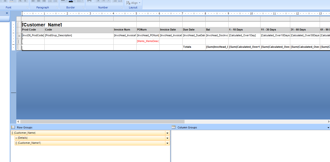

I added the memo description field in within the customer group on the SSRS report. But it comes out like this (memo field in red):
Obviously you can see that i am getting duplicate records. Its supposed to be showing multiple memo lines.
I am assuming that its a grouping issue.
So what am i doing wrong or need to do as far as grouping

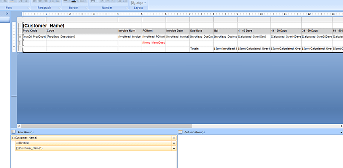

The SSRS in designer:
My Query:
I would use a sub report for this. Or, add a group for invoice and have the memo as the detail section.
Gah, i was hoping I didnt have to do a sub report. I always have such a hard time with sub reports in a SaaS environment.
I’ve done this kind of thing with either a table or list within a group row. You will have to move the invoices into a group to hide the duplicates, and redo your summaries so they don’t include the duplicates. It’s a pain but might be easier than a subreport for you.

Close but the memos i need are linked to the customer record, not the invoice.

I have it filtered by specific memo categories.
I think you’re going to have to do a sub-report. As there is no convenient relationship between the memos and the invoices.

He’s already got the memos linked to the customer. I don’t believe a subreport is necessary here. Group by customer and invoice. Put invoice information in the invoice group header. In the customer group footer, put a table that is grouped by memo number, with information in the group header. Hide detail rows in both tables. Use OVER() and PARTITION BY in a BAQ calculated field to calculate totals without duplicates.

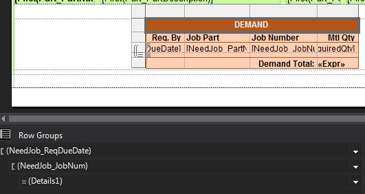

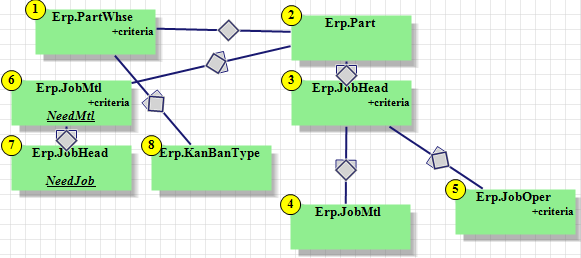

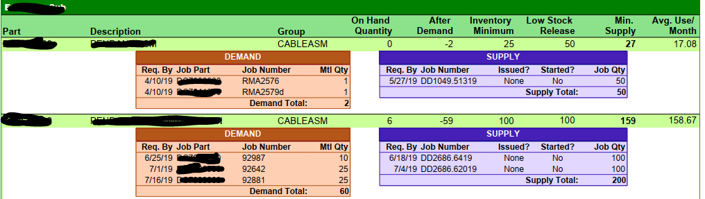

As evidence, here’s something similar I’ve done…this BAQ/report is for determining which midlevel assemblies need to be built so they’re available for top-level assemblies. The single query produces lots of duplicate values.
Main table of report is grouped by kanban code and part number. Part info in the part header, and demand and supply tables in the part footer.
Detailed info in the mini-tables is also in group headers.
Result is no duplicates.
(Please no judging for the style…it was one of my first reports, and the only one that never gets printed, so I got excited about color. :wink: )

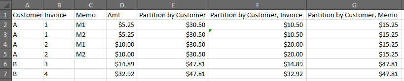

There are internet resources that could probably explain HOW these work better than I can, but for our purposes, it means “add up this expression only where these values match”. Your calculated field would be something like “sum(InvcAmt) over(partition by CustNum, MemoNum)”. Instead of adding up that number in the report, just grab it with First(calculated_total), as it’s already been totaled.
This should work because each memo for a given customer should have one copy of each invoice line. The total for one memo will match the total for another memo, provided they have the same customer. Because the sums are split by memo, they don’t get added more than once.
Here’s a quick example of the records you might get by joining tables this way and using partition for your sums. Customer A has two memos, so each invoice gets repeated twice. If you just add those up, you’ll get the wrong total. But if you partition by customer and memo, it will only add the invoices that match the customer and memo, removing duplicates. (Customer B has no memos, so partitioning by customer would yield the correct total on each line.)
