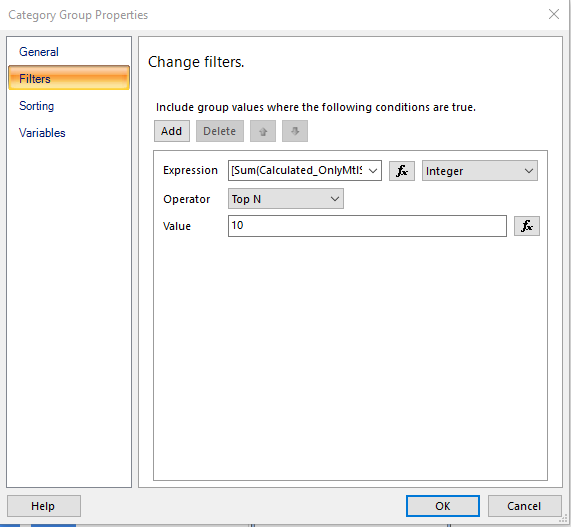

Hello my friend, I struggled with this as well. You need to look under Category Group Properties. See below image, I used it to filter top 10 scrap offenders
In the expression, you can enter whatever calculation you want, but be sure to use either sum or avg if not it will not work.
in the operator select the Top N and in value you can put a number like me or a function.
Hope this helps!
Thank you, yes this worked. I thought i looked through that properties screen, but I was focusing on finding visibility property instead of a filter, Either way thanks for the info it worked perfectly.
