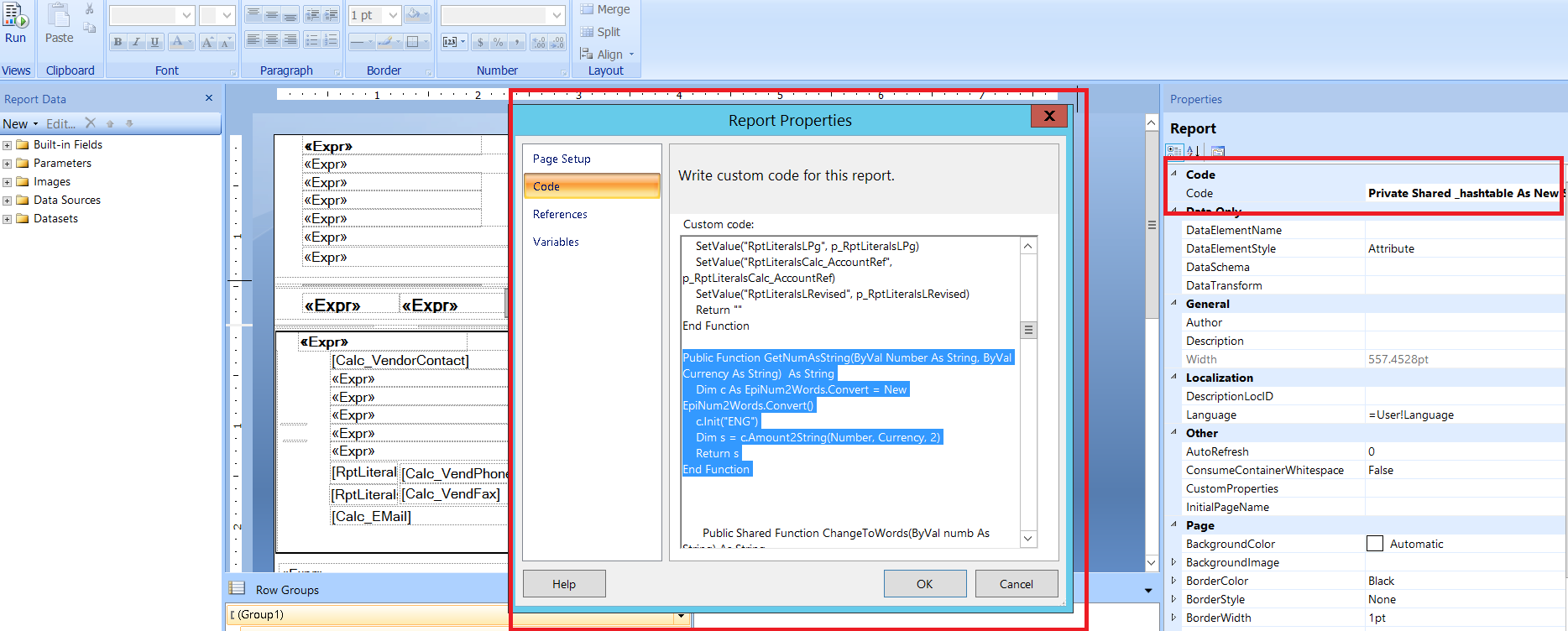

Hi Josecgomez,
Thanks for ur sol. I have checked the dll file is there. Please let me know, I use below code in SSRS
Report Custom Code
Public Function GetNumAsString(ByVal Number As String, ByVal Currency As String) As String
Dim c As EpiNum2Words.Convert = New EpiNum2Words.Convert()
c.Init(“ENG”)
Dim s = c.Amount2String(Number, Currency, 2)
Return s
End Function
But system is throwing error.
Please let me know how to use this code.
