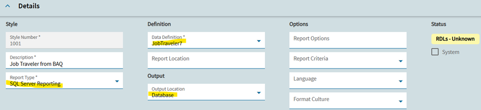

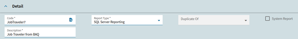

Step 2) Create a new Report Data Definition. The Report Type will be SQL Server Reporting.

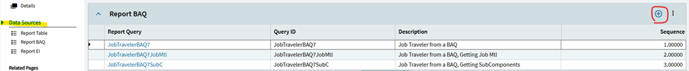

Step 3) Add the BAQs to the Report Data Definition. These are the Data Sources.

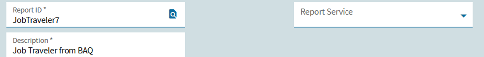

Step 4) Create a report style for the new Report Data Definition. Leave the Report Service blank.
Step 5) Use the plus sign to add a report style. The Report Type is SQL Server Reporting, the data definition is the one you just created, and the output location is database.

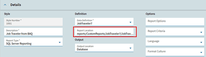

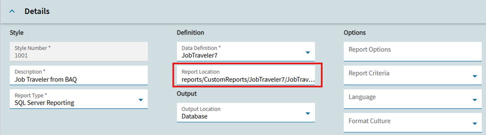

Step 6) Using the 3 dots in the upper right, click “Create SSRS Report”. Epicor will assign a Report Location and create the base SSRS report.
Step 7) Download the newly created report by going back to the 3 dots in the upper right and clicking “Download SSRS Report”.

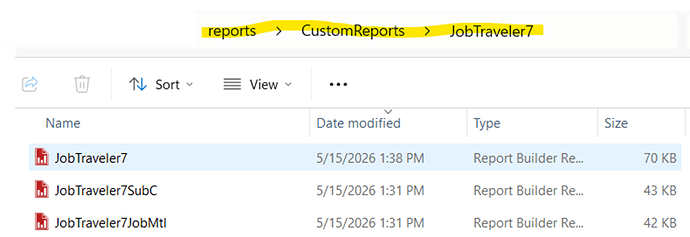

Step 8) Go to your downloads folder. A zipped folder called Reports will be in your downloads folder. Notice that the file path inside the zipped folder will match the Report Location path. You have to continue to maintain this path.

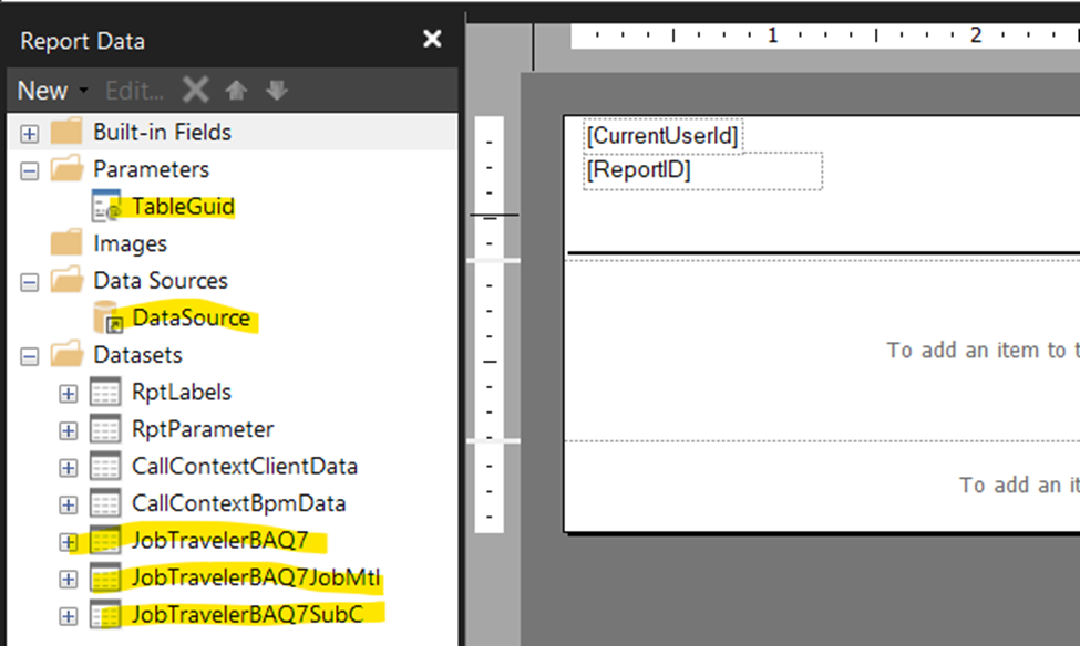

Step 9) Extract the Report Builder File and open it. In this example, there is only 1 SSRS report and it is called JobTraveler7. This report has the TableGuid, the DataSource, and the data from the 3 BAQs as 3 unique data sets.
Step 10) The goal is to have a main report and 2 subreports, so 3 reports total are needed in the report location folder. To get the 3 reports, copy the file JobTraveler7 and paste it 2 times in the same folder. For organization, rename the copied files the same name as the subreport BAQs. When you are finished you will have a folder that looks something like this:
Step 11) Open the SSRS report that is your main report, in this example it is JobTraveler7. You will have 3 datasets in this report. This is your main report and you only need the first dataset. Right click on the next 2 datasets and delete them. The dataset on the main report should look like this now:

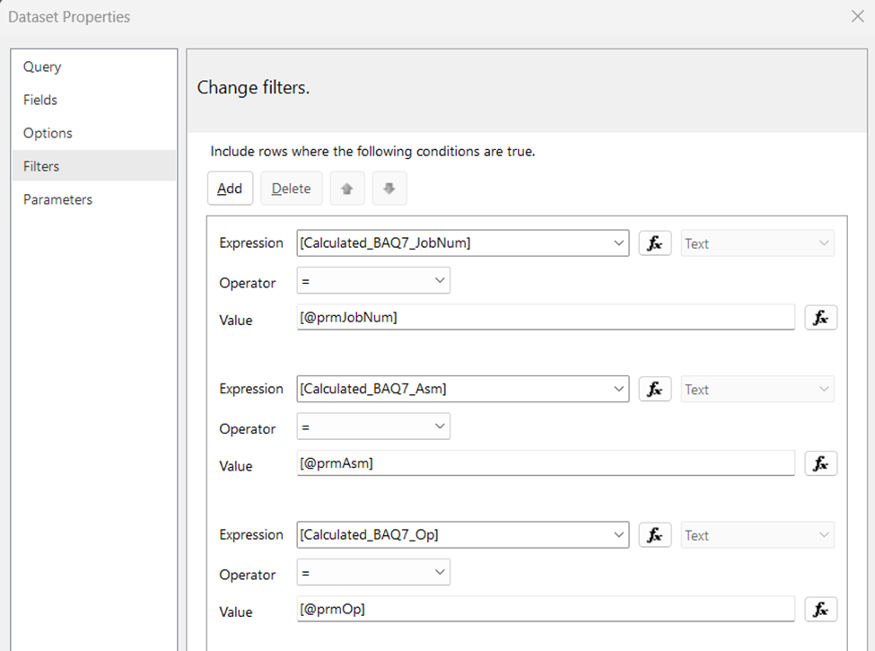

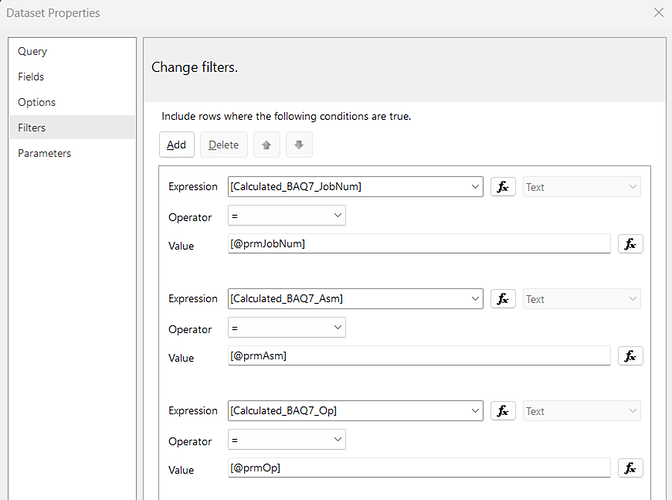

Step 14) Still in the subreport file (JobTraveler7JobMtl), go to the dataset. Right click on the dataset and select Dataset properties.
Step 15) Inside the Dataset properties, go to the filter tab. Add the filters that you need for the subreport. SAVE.

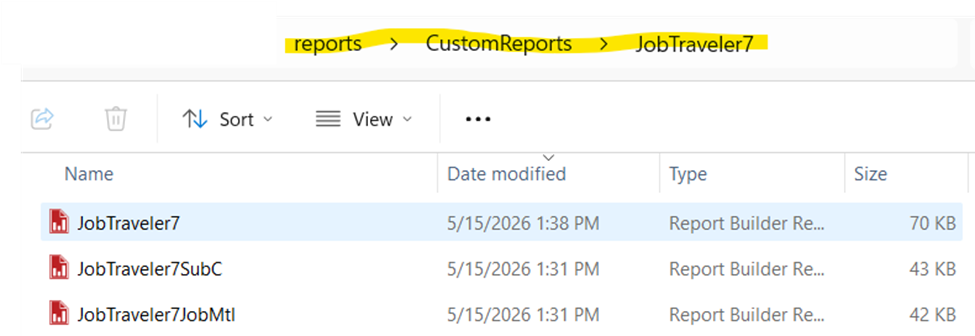

Step 19) Save all the SSRS reports. You should have 3 saved reports in the folder for the report location. Compress the files into a zip folder, maintaining the file path that was listed in step 8.
