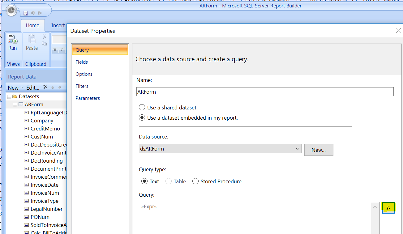

Here is a screenshot on where to see it for those that may not be familiar with SQL Server Report Builder:
The Calc_DspDocLineTax is on the T2 table.
