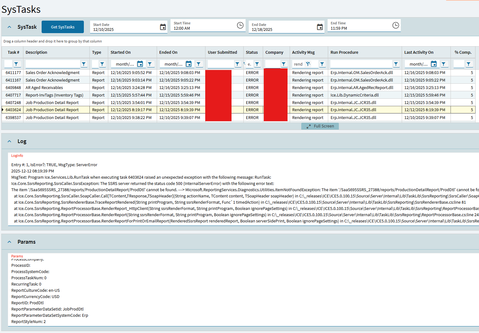

Did you see the one about item not found recently?
Yes, here is the last one from 12/12:
Entry #: 1, IsError?: TRUE, MsgType: ServerError
2025-12-12 08:19:39 PM
MsgText: Program Ice.Services.Lib.RunTask when executing task 6403624 raised an unexpected exception with the following message: RunTask:
Ice.Core.SsrsReporting.SsrsCaller.SsrsException: The SSRS server returned the status code 500 (InternalServerError) with the following error text:
The item '/SaaS695SSRS_27388/reports/ProductionDetailReport/ProdDtl' cannot be found. ---> Microsoft.ReportingServices.Diagnostics.Utilities.ItemNotFoundException: The item '/SaaS695SSRS_27388/reports/ProductionDetailReport/ProdDtl' cannot be found.
   at Ice.Core.SsrsReporting.SsrsCaller.SoapCaller.Call[TContent,TResponse,TSoapHeader](String actionName, TContent content, TSoapHeader soapHeader) in C:\_releases\ICE\ICE5.0.100.15\Source\Server\Internal\Lib\TaskLib\SsrsReporting\SsrsCaller\SoapCaller.cs:line 47
   at Ice.Core.SsrsReporting.SsrsRendererBase.TraceReportRendered(String printProgram, String ssrsRenderFormat, Func`1 timedAction) in C:\_releases\ICE\ICE5.0.100.15\Source\Server\Internal\Lib\TaskLib\SsrsReporting\SsrsRendererBase.cs:line 81
   at Ice.Core.SsrsReporting.ReportProcessorBase.RenderReport_HttpClient(String ssrsRenderFormat, String printProgram, Boolean ignorePageSettings) in C:\_releases\ICE\ICE5.0.100.15\Source\Server\Internal\Lib\TaskLib\SsrsReporting\ReportProcessorBase.cs:line 352
   at Ice.Core.SsrsReporting.ReportProcessorBase.RenderReport(String ssrsRenderFormat, String printProgram, Boolean ignorePageSettings) in C:\_releases\ICE\ICE5.0.100.15\Source\Server\Internal\Lib\TaskLib\SsrsReporting\ReportProcessorBase.cs:line 242
   at Ice.Core.SsrsReporting.ReportProcessorBase.RenderReportForPrintOrEmailReport(RenderedSsrsReport renderedReport, Boolean serverSidePrint, Boolean ignorePageSettings) in C:\_releases\ICE\ICE5.0.100.15\Source\Server\Internal\Lib\TaskLib\SsrsReporting\ReportProcessorBase.cs:line 639
   at Ice.Core.SsrsReporting.ReportProcessorBase.ProcessReportPart(String reportLocation) in C:\_releases\ICE\ICE5.0.100.15\Source\Server\Internal\Lib\TaskLib\SsrsReporting\ReportProcessorBase.cs:line 153
   at Ice.Core.SsrsReporting.StandardReportProcessor.ProcessReportParts() in C:\_releases\ICE\ICE5.0.100.15\Source\Server\Internal\Lib\TaskLib\SsrsReporting\StandardReportProcessor.cs:line 31
   at Ice.Core.RoutingAndBreaking.ReportPersister.Persist(ReportInstanceInformation reportInstance, Func`2 reportsRenderer, Action`1 fillSysRptLstRow, Action`2 processReport, Func`3 filterTableAttachmentsFunc)
   at Ice.Core.RptBase.ReportSsrsDatabaseBuilder.RenderUnroutedSsrsReport() in C:\_releases\ICE\ICE5.0.100.15\Source\Server\Internal\Lib\TaskLib\RptBase\ReportSsrsDatabaseBuilder.cs:line 355
   at Ice.Core.RptTaskBase`1.XMLClose() in C:\_releases\ICE\ICE5.0.100.15\Source\Server\Internal\Lib\TaskLib\RptBase\RptTaskBase.cs:line 219
   at Erp.Internal.JC.JCR35.RunProcess(Int64 instanceTaskNum, String outputFileName) in C:\_releases\ERP\ERP12.0.100.0\Source\Server\Internal\JC\JCR35\JCR35.cs:line 921
   at Ice.Hosting.TaskCaller.InnerExecuteTask(IceDataContext newContext) in C:\_releases\ICE\ICE5.0.100.15\Source\Server\Framework\Epicor.Ice\Hosting\TaskCaller\TaskCaller.cs:line 70
   at Ice.Hosting.TaskCaller.ExecuteTask() in C:\_releases\ICE\ICE5.0.100.15\Source\Server\Framework\Epicor.Ice\Hosting\TaskCaller\TaskCaller.cs:line 61
   at Ice.Lib.RunTask.BpmFriendlyTaskLauncher.Run(String sessionIdPrefix, IceContext db, Action taskRunner) in C:\_releases\ICE\ICE5.0.100.15\Source\Server\Services\Lib\RunTask\BpmFriendlyTaskLauncher.cs:line 57
   at Ice.Services.Lib.RunTaskSvc.InnerRunTask(Int64 ipTaskNum, Boolean suppressTransaction) in C:\_releases\ICE\ICE5.0.100.15\Source\Server\Services\Lib\RunTask\RunTask.cs:line 411

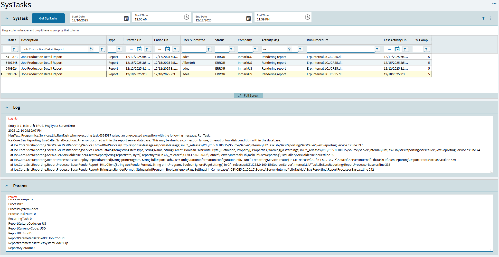

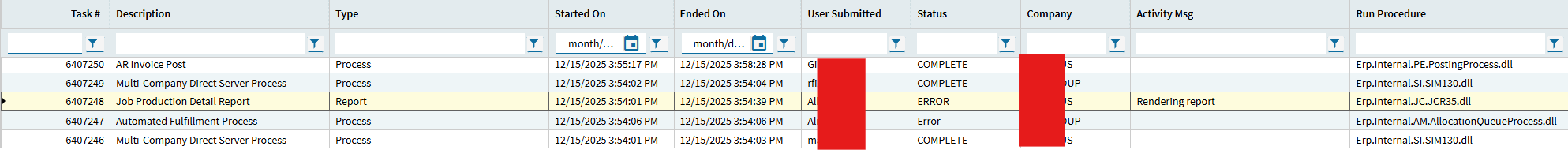

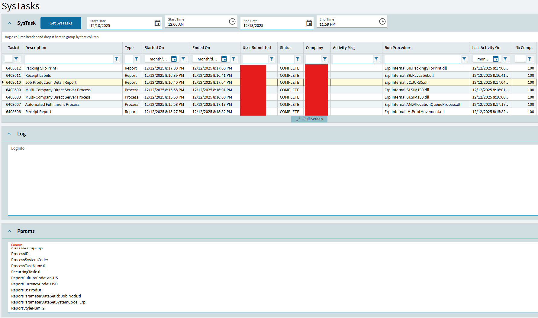

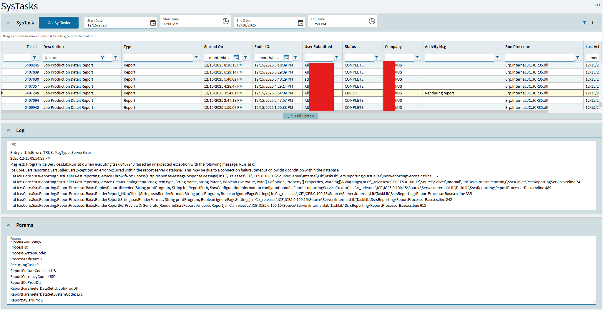

What is the error in the previous row for the same report?
Same Report/RDD/Style (Out of box) printed 3 minutes prior to error run. same user, same company, no error.

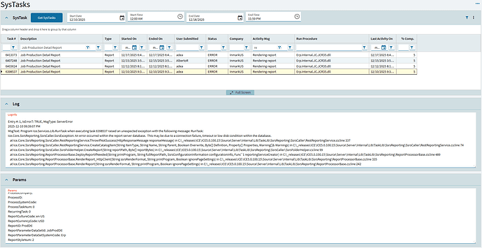

Previous error on same report was 2 days prior:
2025-12-10 09:39:07 PM
MsgText: Program Ice.Services.Lib.RunTask when executing task 6398537 raised an unexpected exception with the following message: RunTask:
Ice.Core.SsrsReporting.SsrsCaller.SsrsException: An error occurred within the report server database.  This may be due to a connection failure, timeout or low disk condition within the database.
   at Ice.Core.SsrsReporting.SsrsCaller.RestReportingService.ThrowIfNotSuccess(HttpResponseMessage responseMessage) in C:\_releases\ICE\ICE5.0.100.15\Source\Server\Internal\Lib\TaskLib\SsrsReporting\SsrsCaller\RestReportingService.cs:line 337
   at Ice.Core.SsrsReporting.SsrsCaller.RestReportingService.CreateCatalogItem(String ItemType, String Name, String Parent, Boolean Overwrite, Byte[] Definition, Property[] Properties, Warning[]& Warnings) in C:\_releases\ICE\ICE5.0.100.15\Source\Server\Internal\Lib\TaskLib\SsrsReporting\SsrsCaller\RestReportingService.cs:line 74
   at Ice.Core.SsrsReporting.SsrsCaller.SsrsFolderHelper.CreateReport(String reportPath, Byte[] reportBytes) in C:\_releases\ICE\ICE5.0.100.15\Source\Server\Internal\Lib\TaskLib\SsrsReporting\SsrsCaller\SsrsFolderHelper.cs:line 99
   at Ice.Core.SsrsReporting.ReportProcessorBase.DeployReportIfNeeded(String printProgram, String fullReportPath, SsrsConfigurationInformation configurationInfo, Func`1 reportingServiceCreator) in C:\_releases\ICE\ICE5.0.100.15\Source\Server\Internal\Lib\TaskLib\SsrsReporting\ReportProcessorBase.cs:line 489
   at Ice.Core.SsrsReporting.ReportProcessorBase.RenderReport_HttpClient(String ssrsRenderFormat, String printProgram, Boolean ignorePageSettings) in C:\_releases\ICE\ICE5.0.100.15\Source\Server\Internal\Lib\TaskLib\SsrsReporting\ReportProcessorBase.cs:line 335
This is the error when attempting to upload:
Error Detail
Correlation ID:  5b3a495f-6009-49ec-9c43-1748e63b7ff5
Description:  An error occurred within the report server database.  This may be due to a connection failure, timeout or low disk condition within the database.
Program:  Ice.Core.TaskBase.dll
Method:  .ctor
Line Number:  40
Column Number:  11

Here is a new one. Love the exceptional detail.
Server Side Exception
Error Detail
Correlation ID:  fb24760f-c63a-4ba2-8694-81a0f626be62
Method:  .ctor
Line Number:  40
Column Number:  11
Client Stack Trace
   at Epicor.ServiceModel.Channels.ImplBase.CallWithCommunicationFailureRetry(String methodName, ProxyValuesIn valuesIn, ProxyValuesOut valuesOut, RestRpcValueSerializer serializer)
   at Epicor.ServiceModel.Channels.ImplBase.CallWithMultistepBpmHandling(String methodName, ProxyValuesIn valuesIn, ProxyValuesOut valuesOut, Boolean useSparseCopy)
   at Epicor.ServiceModel.Channels.ImplBase.Call(String methodName, ProxyValuesIn valuesIn, ProxyValuesOut valuesOut, Boolean useSparseCopy)
   at Ice.Proxy.BO.SsrsReportDesignImpl.UploadAndRenderDesign(Guid sysRowID, Byte[] compressedReportDefinitions, String outputFormat)
   at Ice.Adapters.SsrsReportDesignAdapter.UploadAndRenderDesign(Guid sysRowID, Byte[] compressedReportDefinitions, String outputFormat)
   at Ice.UI.App.SsrsReportDesign.Transaction.UploadAndRender()
   at Ice.UI.App.SsrsReportDesign.ReportDesignForm.BaseToolbarsManager_ToolClick(Object sender, ToolClickEventArgs e)
   at Infragistics.Win.UltraWinToolbars.ToolClickEventHandler.Invoke(Object sender, ToolClickEventArgs e)
   at Infragistics.Win.UltraWinToolbars.UltraToolbarsManager.OnToolClick(ToolClickEventArgs e)
   at Infragistics.Win.UltraWinToolbars.UltraToolbarsManager.FireEvent(ToolbarEventIds id, EventArgs e)
   at Infragistics.Win.UltraWinToolbars.ToolBase.OnToolClick()
   at Infragistics.Win.UltraWinToolbars.ToolMenuItem.OnClick()
   at Infragistics.Win.UltraWinToolbars.PopupMenuItemUIElement.DoClickProcessing(MouseEventArgs e)
   at Infragistics.Win.UltraWinToolbars.PopupMenuItemUIElement.OnMouseUp(MouseEventArgs e)
   at Infragistics.Win.TextUIElementBase.OnMouseUp(MouseEventArgs e)
   at Infragistics.Win.ControlUIElementBase.ProcessMouseUpHelper(Object sender, MouseEventArgs e)
   at Infragistics.Win.ControlUIElementBase.ProcessMouseUp(Object sender, MouseEventArgs e)
   at Infragistics.Win.Utilities.ProcessEvent(Control control, ProcessEvent eventToProcess, EventArgs e)
   at Infragistics.Win.UltraWinToolbars.PopupControlBase.OnMouseUp(MouseEventArgs e)
   at System.Windows.Forms.Control.WmMouseUp(Message& m, MouseButtons button, Int32 clicks)
   at System.Windows.Forms.Control.WndProc(Message& m)
   at System.Windows.Forms.Control.ControlNativeWindow.OnMessage(Message& m)
   at System.Windows.Forms.Control.ControlNativeWindow.WndProc(Message& m)
   at System.Windows.Forms.NativeWindow.Callback(IntPtr hWnd, Int32 msg, IntPtr wparam, IntPtr lparam)
What is the server log exception?
Client stack is not very helpful actually.
We only know server method SsrsReportDesignImpl.UploadAndRenderDesign, but its details still need to be found on server.
