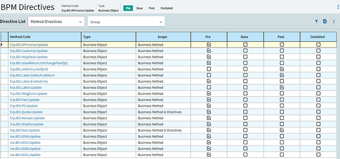

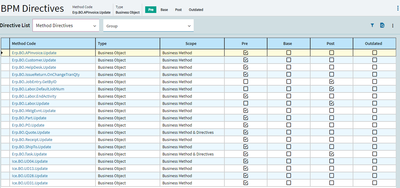

That doesn’t seem to be an option in BPM designer, in fact there doesn’t seem to be many options at all in our BPM designer. Maybe I don’t have access to view them?
Hi James,
From your screenshot, you are in the right place (method directives)

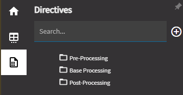

Then on the upper left hand side, hit the plus icon to create a new “Pre” directive

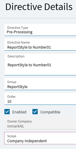

Set the directive details up something like this:
