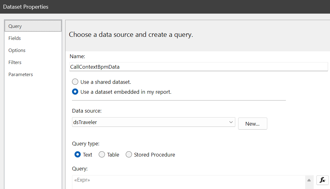

Add a new dataset. Name it CallContextBpmData, set the Data Source to the existing source of dsTraveler.
Hit fx to create a query
Use this for your query:
="SELECT * FROM CallContextBpmData_" + Parameters!TableGuid.Value + " T1"
That will pull the “CallContextBpmData” object that we modified earlier to set Number01 to our Report Style from the BPM. (we pull all fields because we are lazy, and who knows when we might want to add more to expand the usage)

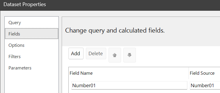

Now, save the query (hit ok), then go to “Fields” section of the “CallContextBpmData” Dataset Properties, and add “Number01” to your fields.
