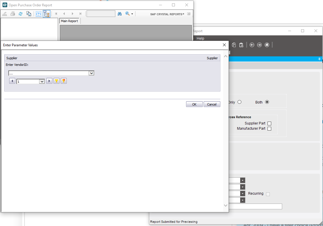

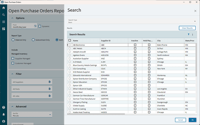

I have a Crystal Report that allows for this:
A pop up filter that lets users sort by supplier/vendor. Now this isn’t a BAQ, this is based off OpenPO report native to Epicor.
Is there a way to do something similar with SSRS?

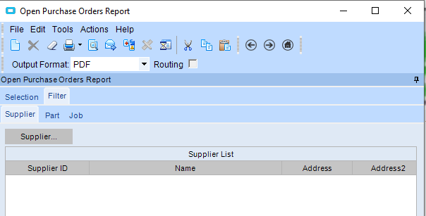

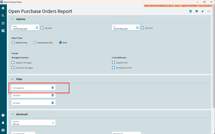

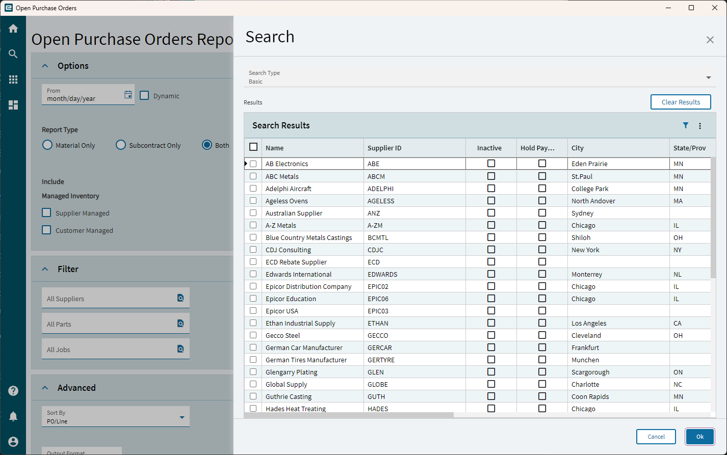

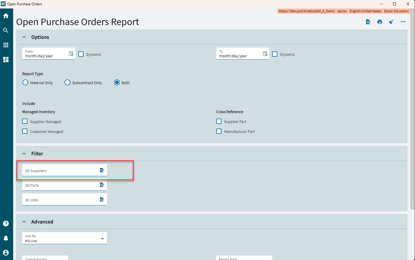

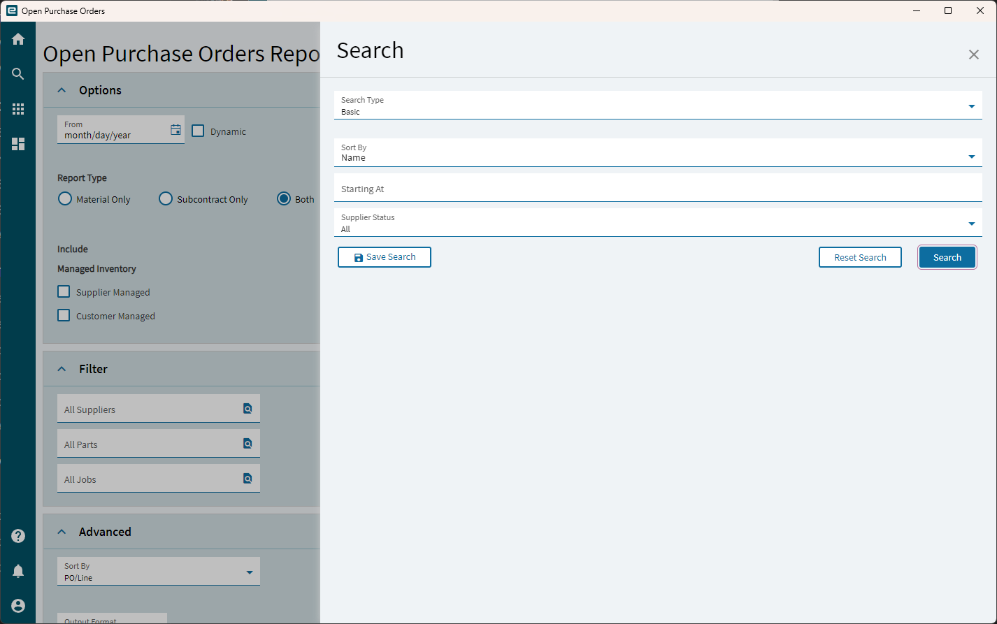

You can filter by supplier(s) on the filter tab
Ahh, nothing else then? The CR one offers a drop down, for example.

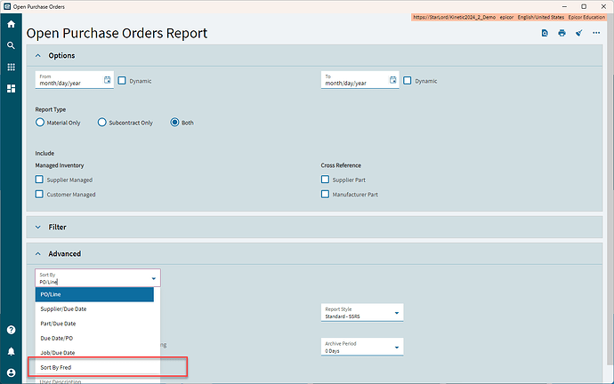

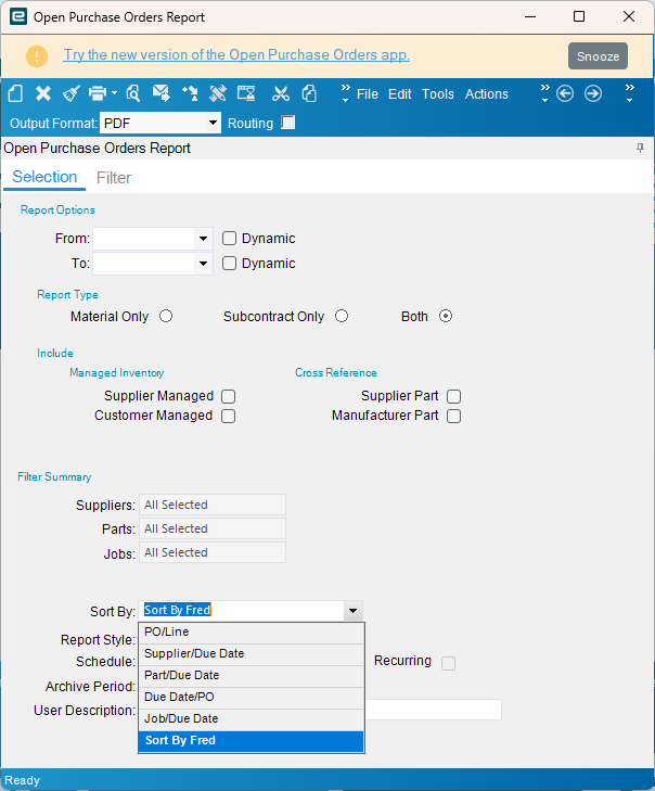

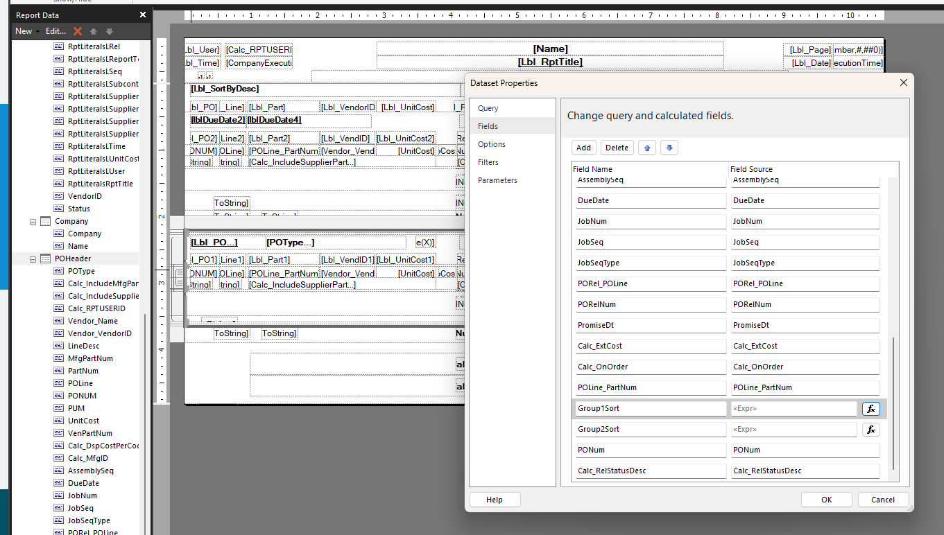

So if you are wanting to add an additional sort order there are a few steps you need to.

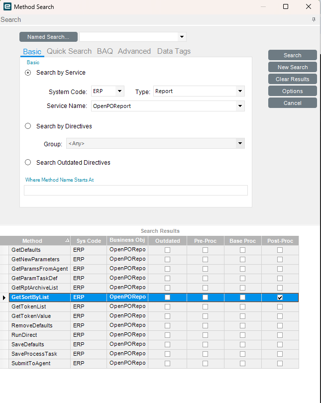

Find the method for Erp.Rpt.OpenPOReport.GetSortByList (replace the report name for whatever report you want to add the sort to. I think you will find not all reports have a sort (I might be wrong).

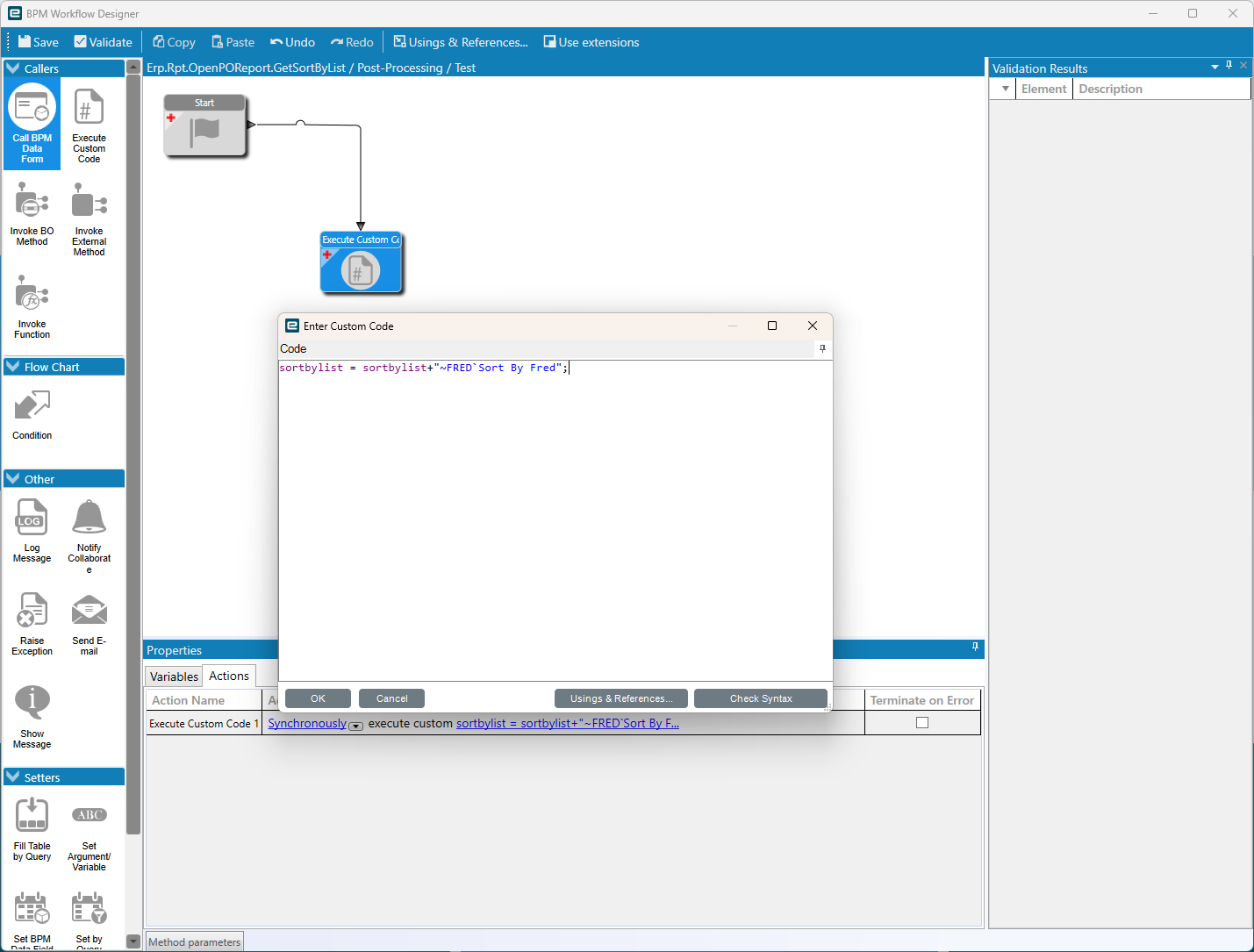

Add post processing BPM to inject the new sort value and label.
Modify the formula in the RDL to include the new sort value. It may differ from report to report, but for Open PO I saw two grouping formulas.
End result of the report params forms are:
I hope that helps.
Correct me if I am misunderstanding, but only allows it to sort by supplier. They want to see a drop down and select which supplier, like it can for the CR version. Is this built into CR or a function of Epicor?
