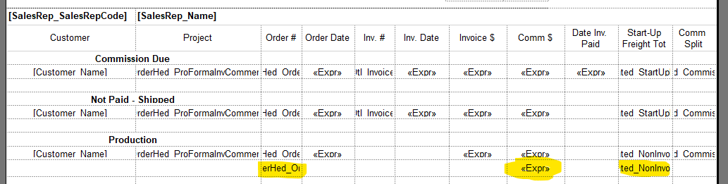

Good Idea…probably should’ve done this originally. So, lets say I take the last group, which is named Production (and is the last detail row, under the Production label), and add totals after the group (which are highlighted yellow).
For example we can use the middle item (under the comm $ header)…which has an expression of
=Sum(Fields!Calculated_OrderTotalComm.Value, "Production") - Sum(Fields!Calculated_InvoiceTotalComm.Value, "Production")
Production is the name of the group, and I have the group grouped by OrderNum, along with some filters. This expression is taking the order commission less any invoice commissions. The totals expression given to me for this is the exact same expression.

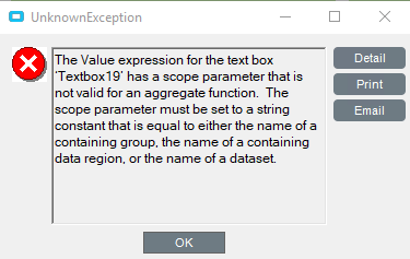

When trying to upload to a report style I get this error
With the textbox19 being the totals expression. All I really want is to grab all totals of that textbox for the current rep.
For now, just take the formula out of the textbox19. Set the expression to 1, or something static just so we can get the report to upload and run. I downloaded your RDL but, I do not see any Textbox19, so you may have made edits after you uploaded, or there is something else going on here. Post the BAQ too.

From what I can see, totals work within the same group scope, but then it ends up just totaling each detail row instead of the entire group.
