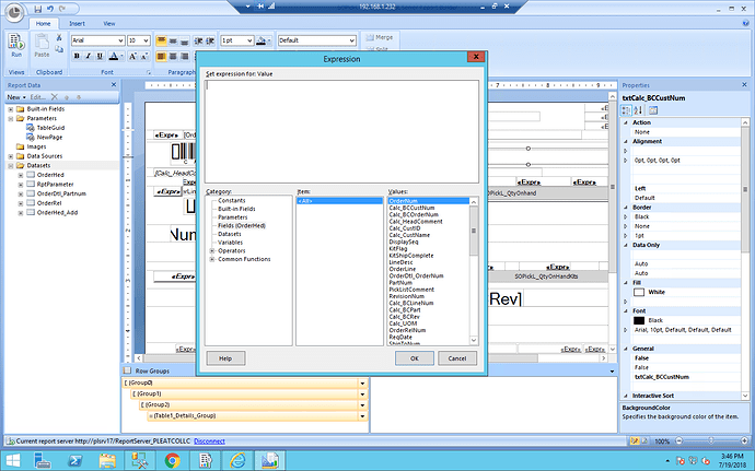

Hi! I am going through the same issues with a report (SO Pick List). I am trying to add the CALC Ship To Adress on each page.
I am trying to follow the steps but not getting it. Started playing around with SSRS. I understand how to add tables to the reports and view them etc.
So i added multiples tables as datasets. But i only have the OrderHed table in the fields section (which displays each field instead of the first like the datasets.
So is there a way to add the table to the fields section? If not, i am trying to do the steps above but not sure where to start. I need to add a matrix anywhere in the report. Hide it and then create a field in the header that shows the matrix each record. Where i keep getting stuck is creating the matrix. Any more detail guidelines?
