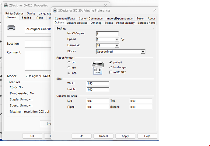

Mr. Jarrad: I would start by checking the default label settings in the printer properties of the PC printing the labels And/Or check the printer properties of the server you are using to print the labels.

do you think the size is what I should be checking or any setting in here specifically I should focus on?

This was ultimately the answer. I had to reconfigure the Printer settings to work with the label. The label size was not set up properly, perhaps this printer was used for a different label at some point in time, but the labels were a little bit larger than the ones we were actually using, so I had to adjust the size and the content of my label started to look way better. then I used a Top Margin to push the content down and it looks good.
