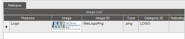

I had this problem too, but I was working with an Epicor consultant and he fixed it. As I recall, Epicor likes a .png file. We had to change mine from a .jpeg to a .png. Hope that helps.
