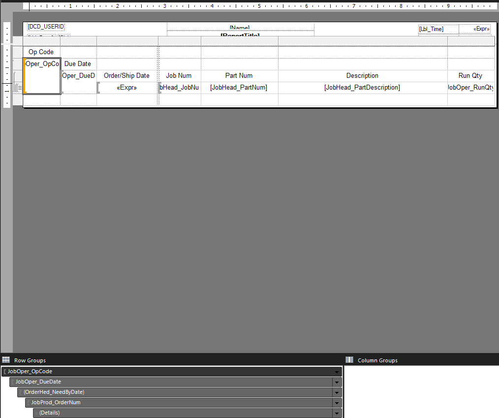

I need to add a blank row to this SSRS. I have one added in, but its not showing up in the printed form.

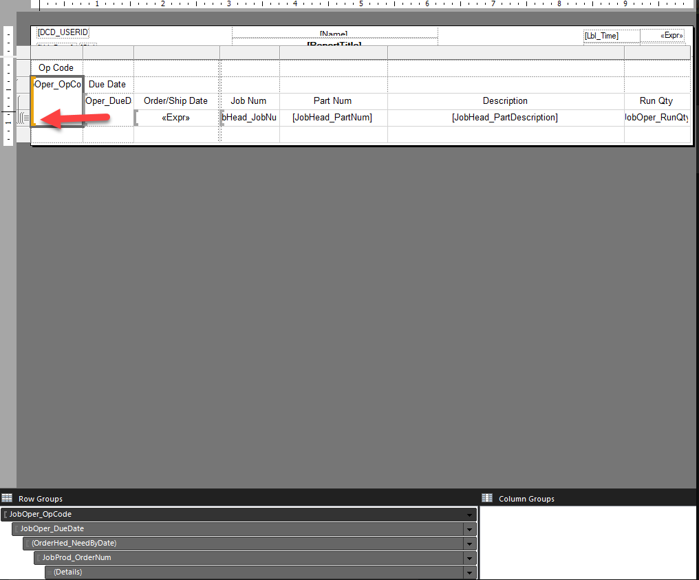

You want to add the row as a second Detail row. So you will have two rows with the 3 lines like the one I’m pointing to.
