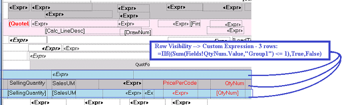

For now, here is a very simplistic expression I tried for row visibility.
Might give you some ideas.

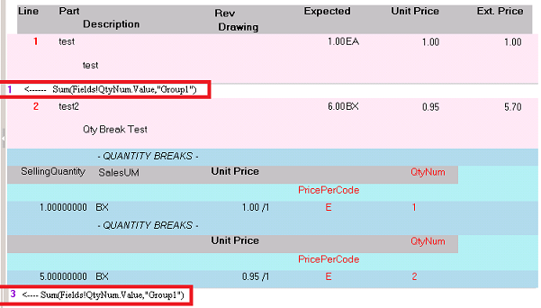

=IIf((Sum(Fields!QtyNum.Value,“Group1”) <= 1),True,False)
Also, I sometimes have good luck searching Google when I have SSRS questions.
Ref screen shots
- Report Builder
- and print preview
