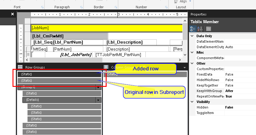

@cchang - If you get the warning about matching settings, make sure you set all the rows above the group the same.

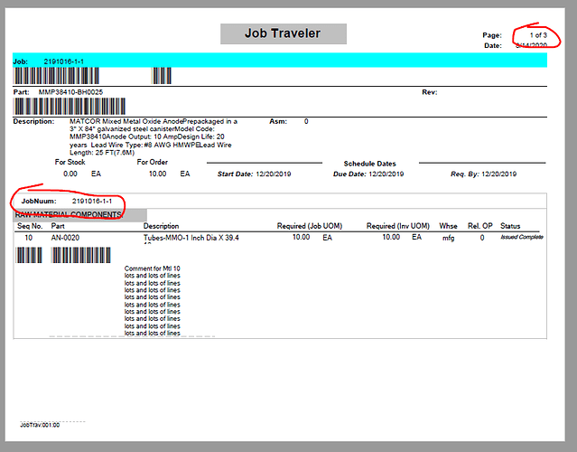

Our main end goal is to get the job number in the header section of all pages. What we are trying to do here is a workaround but we would want the job number in the header section of all pages from the main report. It’s possible when printing the job traveler, the pages gets cut off and want to keep it consistent to have it printed on the header. Have you tried this in the main job traveler report and not the subreport?
If you try printing the job traveler in batches with multiple jobs and select all the parameters during print prompt, there are times the subsequent pages are not referenced to any job numbers and we would like all subsequent pages to have the associated job number.

Your best bet is to do what @jkane said, to the subreports.

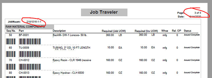

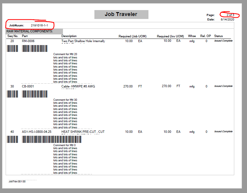

Here’s What I end up with:
