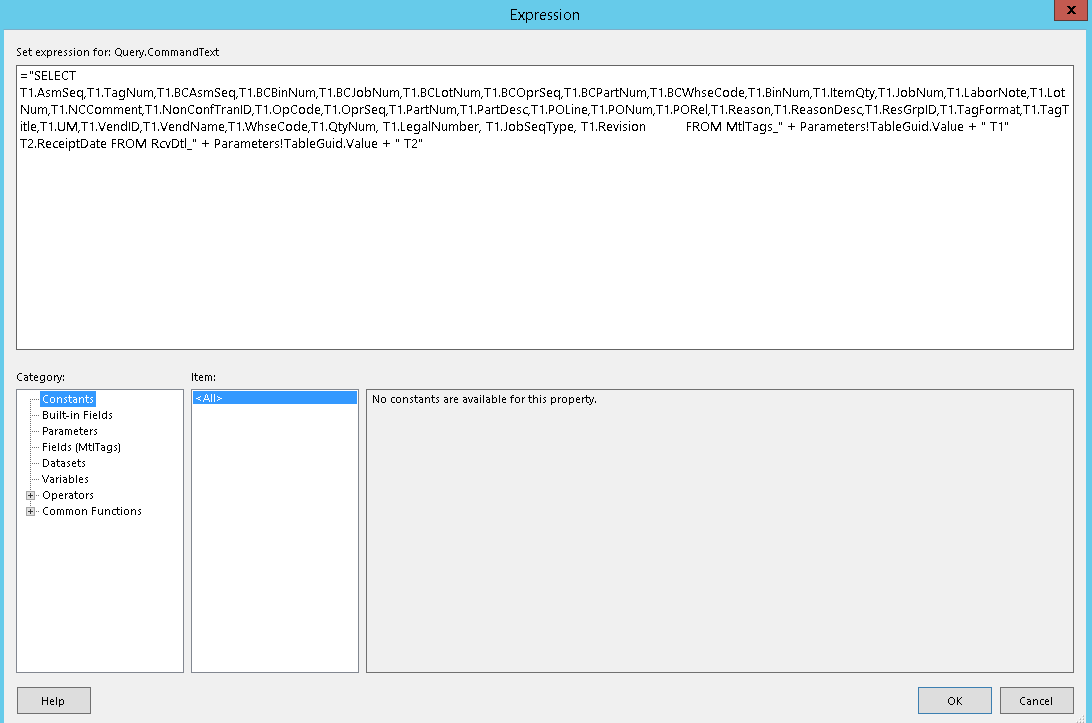

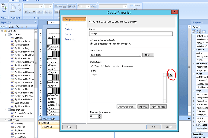

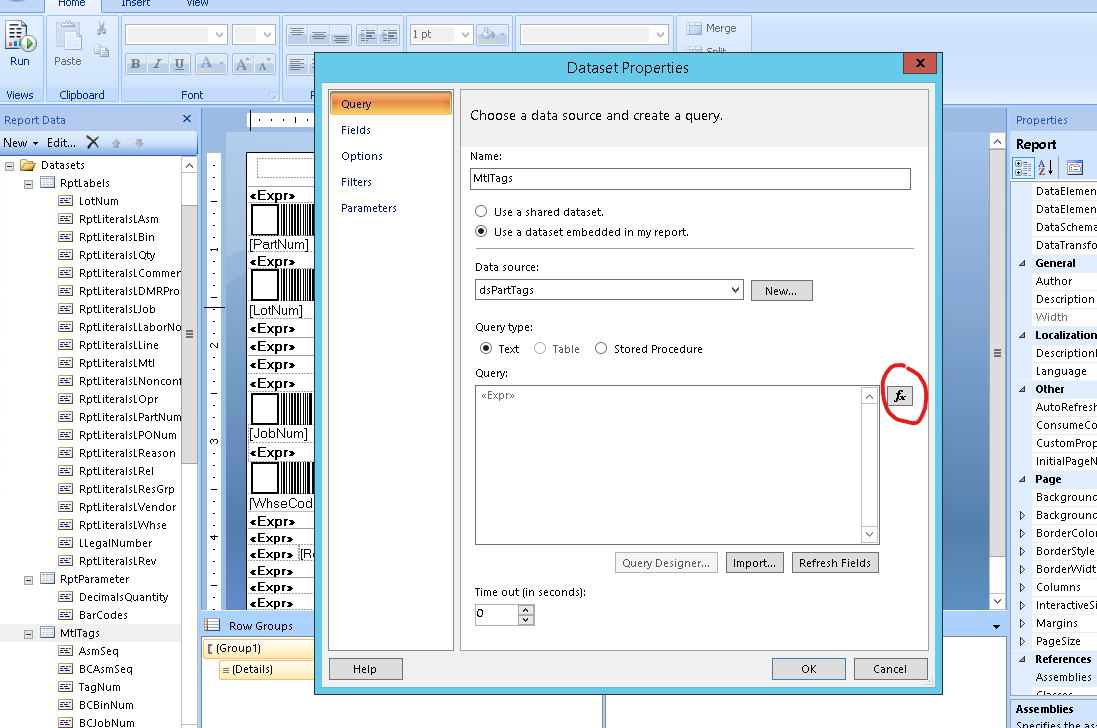

Here are some screenshots of where you will need to edit the RDL dataset query in Report Builder:
Follow the syntax in the dataset already to get the field from the table you would like.

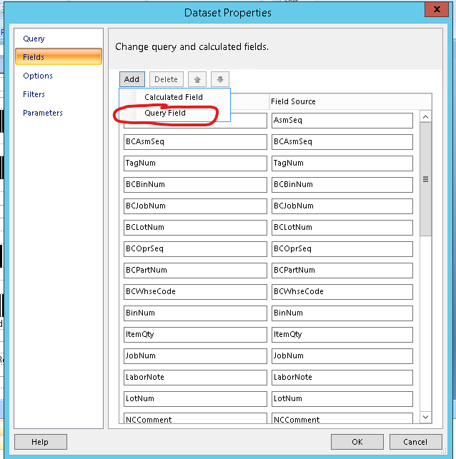

Then, you will have to add it in as a query field:

I have used the photos that @jorel has provided and have made a query field for what I am after. In my case T4 = our JobMtl table. I added T4.PartNum to the end of the query for this report and then added a query field called JobMtlPartNum and set it equal to PartNum. The issue I am having now is that it is defaulting to our NonComf PartNum instead of our JobMtl PartNum. What do I need to do to get it to go to the correct PartNum?

You could give the PartNum you are looking for an alias. At the end of the query you can do “T4.PartNum as JobMtlPartNum” Then in the query field that you added change it to the alias you gave it instead of PartNum.
Having done that the report returns a blank instead of a part number. Any idea why that is?
