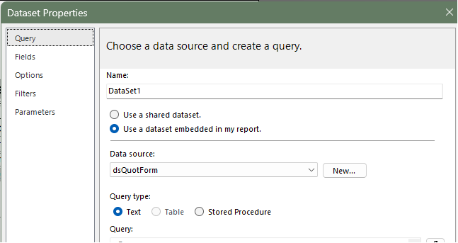

in SSRS (Microsoft Report Builder), add a Dataset
Pick the existing shared data source (I took this to mean select Use a dataset embedded in my report
for the Query add this
=“SELECT T1.CurrentUserId FROM CallContextClientData_” + Parameters!TableGuid.Value + " T1”
And then add CurrentUserId as a field.
Then use this in the text box you want to show the userid of who ran the report.
=First(Fields!CurrentUserId.Value, “DataSet1”)
