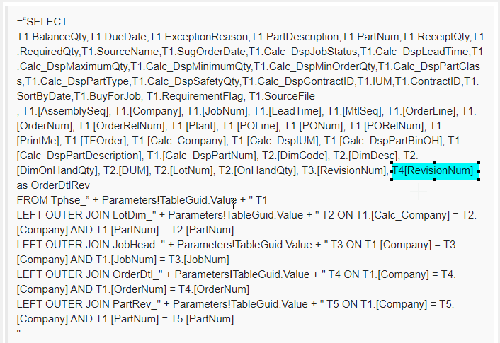

Below is how I currently have my joins created.
=“SELECT T1.BalanceQty,T1.DueDate,T1.ExceptionReason,T1.PartDescription,T1.PartNum,T1.ReceiptQty,T1.RequiredQty,T1.SourceName,T1.SugOrderDate,T1.Calc_DspJobStatus,T1.Calc_DspLeadTime,T1.Calc_DspMaximumQty,T1.Calc_DspMinimumQty,T1.Calc_DspMinOrderQty,T1.Calc_DspPartClass,T1.Calc_DspPartType,T1.Calc_DspSafetyQty,T1.Calc_DspContractID,T1.IUM,T1.ContractID,T1.SortByDate,T1.BuyForJob, T1.RequirementFlag, T1.SourceFile
, T1.[AssemblySeq], T1.[Company], T1.[JobNum], T1.[LeadTime], T1.[MtlSeq], T1.[OrderLine], T1.[OrderNum], T1.[OrderRelNum], T1.[Plant], T1.[POLine], T1.[PONum], T1.[PORelNum], T1.[PrintMe], T1.[TFOrder], T1.[Calc_Company], T1.[Calc_DspIUM], T1.[Calc_DspPartBinOH], T1.[Calc_DspPartDescription], T1.[Calc_DspPartNum], T2.[DimCode], T2.[DimDesc], T2.[DimOnHandQty], T2.[DUM], T2.[LotNum], T2.[OnHandQty], T3.[RevisionNum], T4[RevisionNum] as OrderDtlRev
FROM Tphse_” + Parameters!TableGuid.Value + " T1
LEFT OUTER JOIN LotDim_" + Parameters!TableGuid.Value + " T2 ON T1.[Calc_Company] = T2.[Company] AND T1.[PartNum] = T2.[PartNum]
LEFT OUTER JOIN JobHead_" + Parameters!TableGuid.Value + " T3 ON T1.[Company] = T3.[Company] AND T1.[JobNum] = T3.[JobNum]
LEFT OUTER JOIN OrderDtl_" + Parameters!TableGuid.Value + " T4 ON T1.[Company] = T4.[Company] AND T1.[OrderNum] = T4.[OrderNum]
LEFT OUTER JOIN PartRev_" + Parameters!TableGuid.Value + " T5 ON T1.[Company] = T5.[Company] AND T1.[PartNum] = T5.[PartNum]
Thanks for giving me a walkthrough on this stuff! It seems a little tedious but extremely helpful! Additionally, would i need to make a new field for it on the fields section below query?
