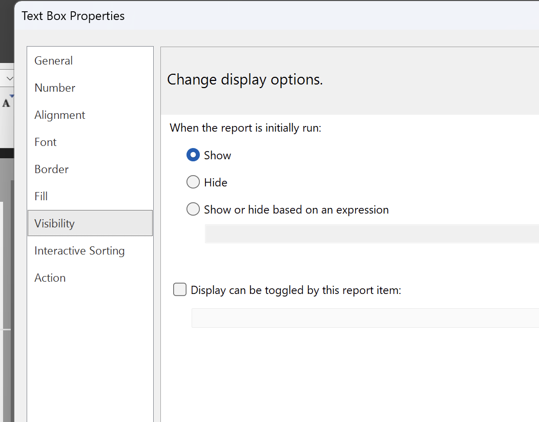

The data is there but it doesn’t want to display beyond the first name. What am I missing?
Figured it out. Was text box properties - visibility.
