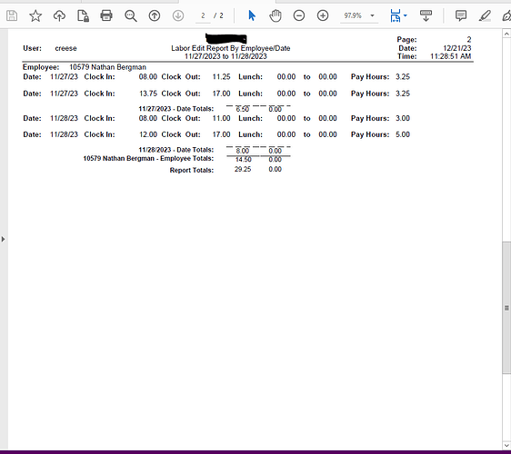

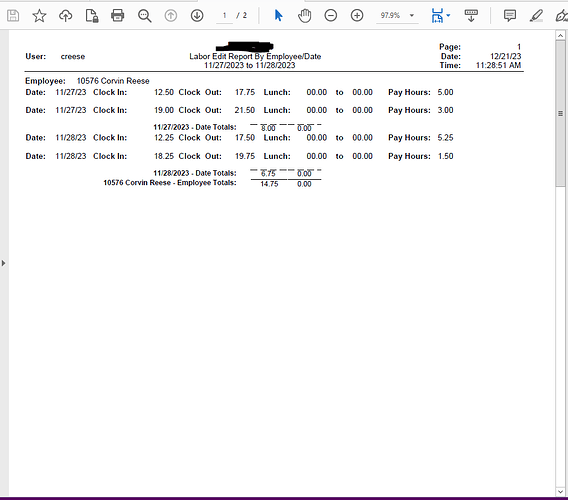

I have two pages and data displays on both pages but there is so much extra room that it could fit on one page. The margins are smaller than a standard paper.

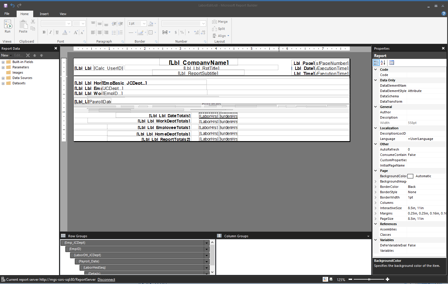

Look through the properties for the various row groups at the bottom there. Look at the page break settings for each group. I bet it is set to break after a group.
Good luck!
Something I like to do is also on the properties on the right side is to set consume container white space to true as well. Helps eat some of that up naturally.
I do think Nate is probably right and that there is a page break somewhere though.
Because you ran it on Employee/Date, it is probably on the EmpID group.
