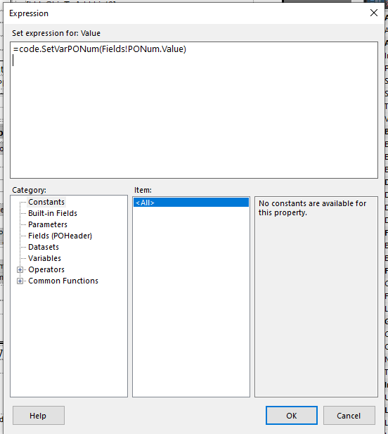

If you set the textbox value expression to = Fields!PONum.Value , does anything show up? The reason I would like to try to put this in that place is to re-set the PO number in the function so that the right one shows up in the header. I think for some reason it is losing the value for that particular po, but I could be wrong.
The other thing that comes to mind is the dataset, is there something wrong with the dataset.
In short, even if you set the value of that textbox to code.SetVarPONum(123456), the number 123456 should show up on the top, but the report might not run because that is used elsewhere to relate other data and what not. I hope I am explaining this somewhat clearly.
Sorry for the wait. It does not return anything, no.

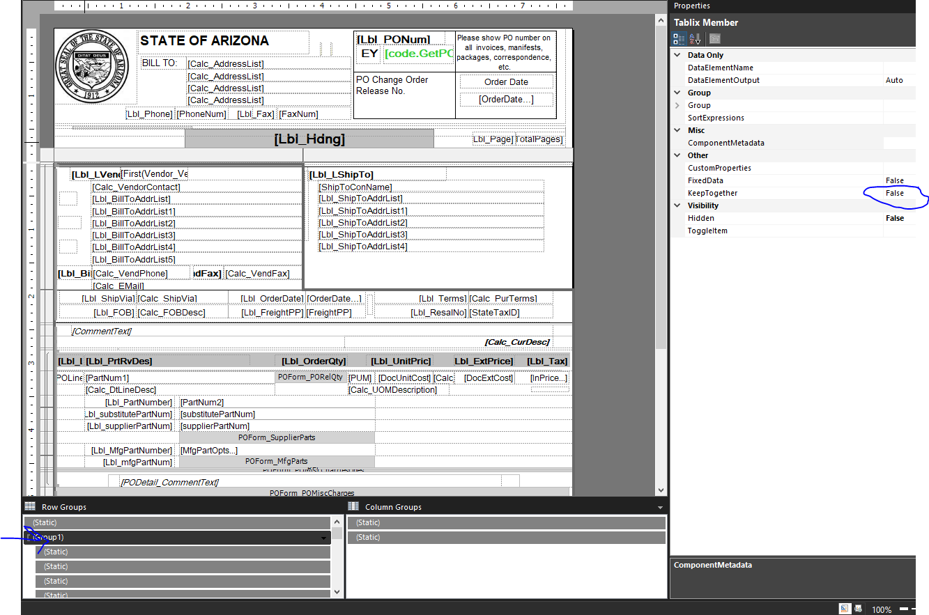

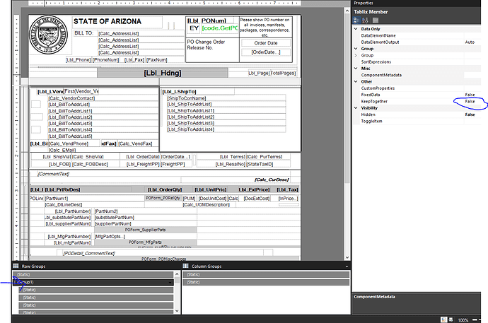

KeepTogether is already set to false for Group1.

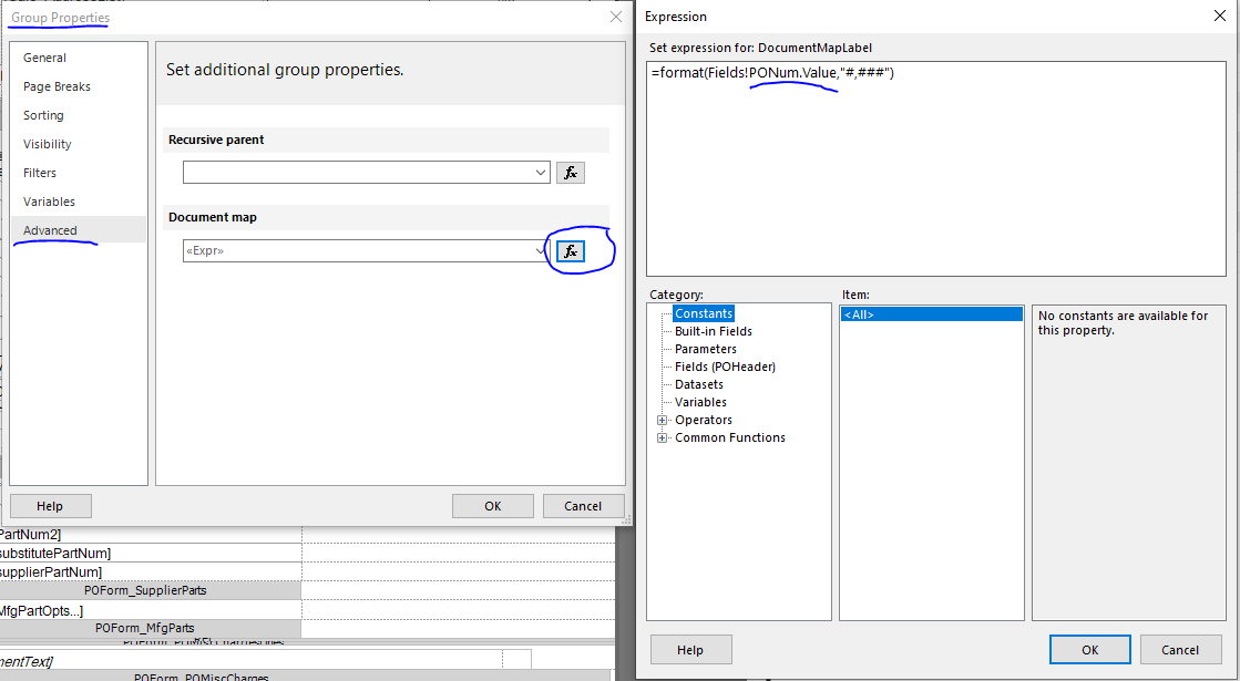

While I was checking that, in Group 1’s Properties, I found this:
Is that the right variable? I’ve never used the Document Map feature, and I don’t know what it’s doing, but wasn’t it the PONum.Value that doesn’t return anything? I may be way off, but I thought I’d ask.

Never used a document map on an SSRS report… at least not knowingly.
