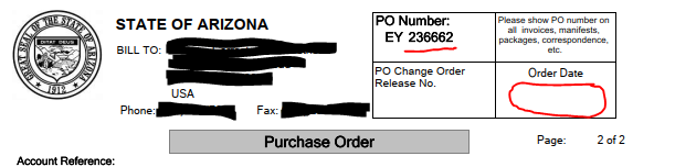

My custom POForm report style has an error when batch printing. If it is used to print a PO individually, all is well. When used to print a batch, some of the POs are printing with the following fields sometimes incorrect:
-PO Numbers (sometimes jump to next PO # on pages after first page of PO)
-Order Date (sometimes blank on pages after first page of PO)
The last batch was 45 pages and included 29 Purchase Orders. All look good until page 14, where on page 2 of the PO, the PO number changes. (It’s supposed to be 23661 but it shows 23662.) Then after that, PO numbers are incorrect on many pages (after the first page) on each PO.

I just ran with the Std SSRS and the PO Numbers are all correct. I re-ran with my custom report and again, all are good until the 4th PO (pg 11), where the number changes on page 2 and the OrderDate is blank on page 2. I’m going to deep dive into the rdl. It’s got to be a little box somewhere with code messing something up, or something incorrectly set. This used to work! I’m going to find it. If you think of anything else, please update.
UPDATE**** I re-ran a mass print with the same PO’s and the report printed with the same exact errors, so it’s not random.
Purchase Order_4thPONumberIsWrongAndBlankOrderDateOnPage2OfPO.pdf (234.7 KB)
So it is only on page two of the PDF, but page one displays just fine?
Yes. In each instance of a problem, it is always on pages AFTER page 1.

The PONum variable that is displayed on the top of the header is re-set each new PO group. On page two there is no group change, but for some reason it is changing.

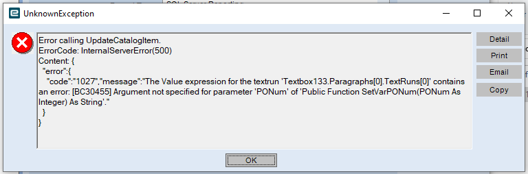

I just added that box to the bottom and got this error:

Does the value of the box say this: =code.SetVarPONum(Fields!PONum.Value)?
I saw that when I copied it, it got changed to this =code.SetVarPONum
it should be =code.SetVarPONum(Fields!PONum.Value)
