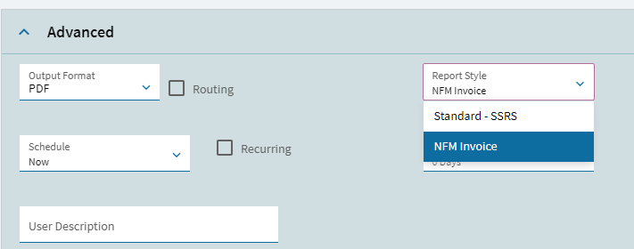

I apologize if this comes off as a mean sounding question… but are you choosing your new style when you print?

I have selected the correct form. Even just made a copy of the standard and only changed on font color as a test and that doesn’t work either.

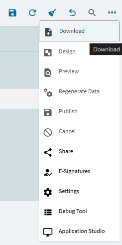

I am using Kinetic web in the browser, cloud hosted on epicor public servers (so latest version I suppose). When I click the “Download” button here :
I get the download notification but nothing else happens and theres nothing in my user’s appdata folder.

Do the “Generate for Design” (I think you got this already).
Open the system monitor – select the row that has the Last Action = None then overflow Design SSRS Report
Click on download:
After the download the “Design” Fields should be populated. Maybe you do not have write access to the AppData folder?
Next click on Design: for my system Report Builder gets launched behind all of the windows it is there – Use Alt-Tab to select the report builder.
When you are done run the Publish,
