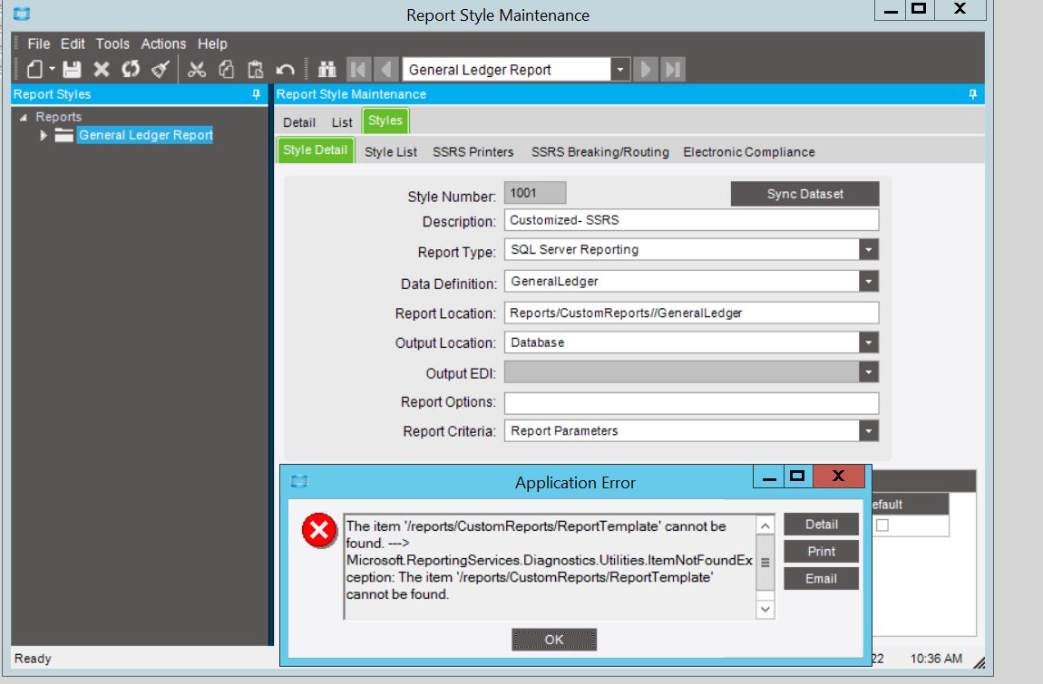

While creating the customized SSRS report, System is throwing below mentioned error
“The item ‘/reports/CustomReports/ReportTemplate’ cannot be found. —> Microsoft.ReportingServices.Diagnostics.Utilities.ItemNotFoundException: The item ‘/reports/CustomReports/ReportTemplate’ cannot be found.”

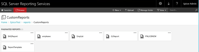

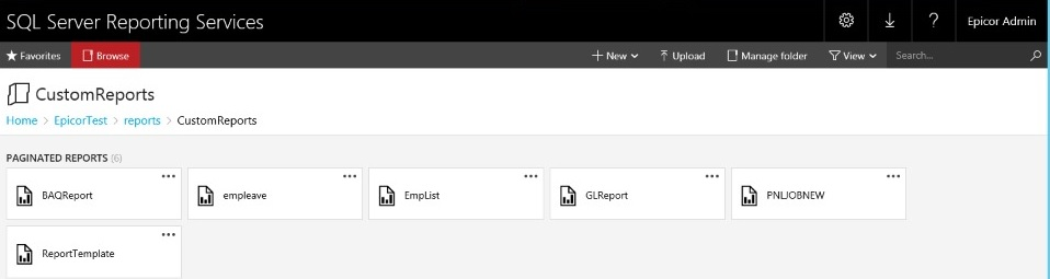

@jkane , I have checked that Report Template file is already exist in the Custom Reports folder.

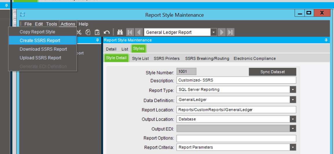

I am creating a new report and have completed the below mentioned steps
Created New BAQ
Created New Data Defination.
Created New Report Style and while click on the “Create SSRS Report” under action menu. System is throwing above error.
