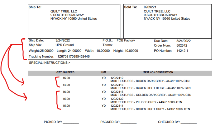

How do I make the line details of a pack slip get grouped by a combination of PO/Order Number? So within the subheader rectangular box that has Ship Date, Ship Via, FOB, Terms, Due Date and PO Number if I include a field for the Order Number, I want that rectangular box to get duplicated over each Order lines detail but have the PO/order number change based on what is included in the pack slip.

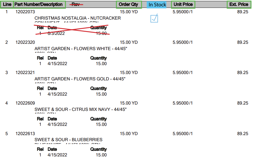

Also, how do I include a checkbox on the order acknowledgment form per line detail to say whether the line part number is in stock or not?
Well I know how to add a field, just wasn’t sure how to make a section duplicate on the form depending on what PO/Order combo the lines were being pulled from as well as adding a checkbox pulling in details on whether a part is in stock or not
Let’s say the first two lines were part of Order 502342 and PO 14242-1, and the last three lines were part of Order 502343 and PO 14111-1. All of the data in the rectangular box would stay the same besides the Order Num and PO Number, but that box would be copied down above the last three lines
Sounds like you need to delete the default groups epicor has setup and recreate your own inside the report. Once you have clicked inside the tablet, you can modify them at the bottom of report builder
